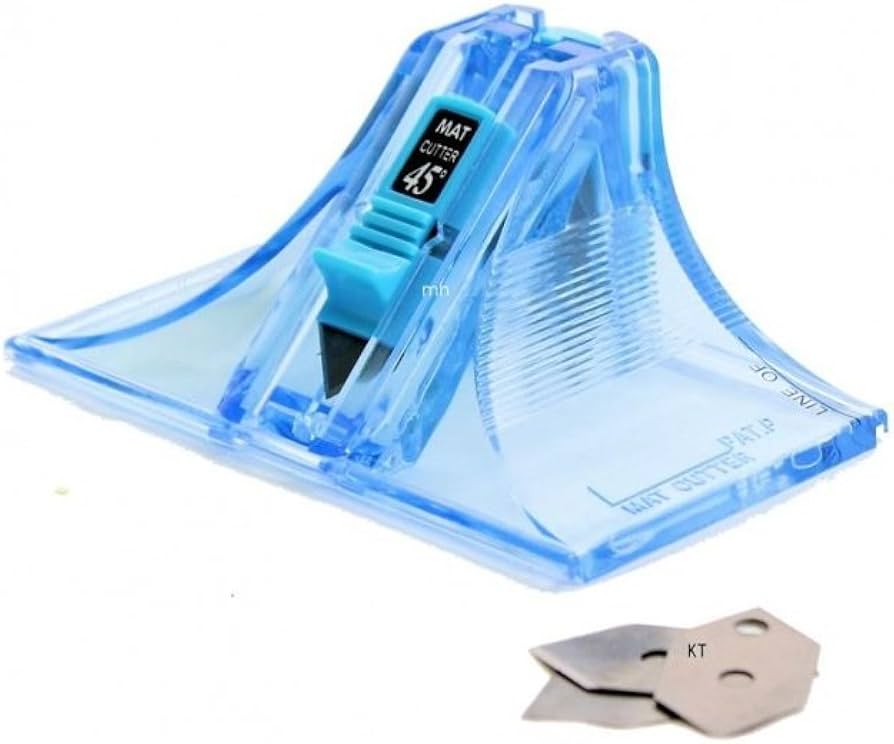

Posts: 57275
As an artist/illustrator I window mount prints all the time. I’ve done hundreds. I just use a basic, standard bevel cutter likethis and a steel ruler. The trick is to change the blades regularly like you would with a razor, so buy loads of blades. Don’t use a cutting mat. Cut it on another piece of mounting board. Use decent board. It’s not cheap. I get mine from a local art supplies shop.
It’s one of those things that you get a feel for as you do it more, with regards to what pressure to apply, so there’s trial and error involved. You’ll get smoother.
my biggest tip would be to relax, stick the radio on, have a brew, take your time, measure everything out properly, but enjoy it. I find it quite therapeutic. I enjoy doing stuff where I need to be really precise
Good luck and enjoy it
