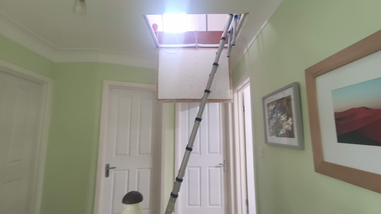

We used to have a clunky metal sliding step ladder into the attic which the wife hated because it was always dropping dirt onto the carpet when it was opened regardless of how much you cleaned it and was difficult to put away as it covered half the available attic floor when stored. When I converted half the loft to an art studio I replaced those steps with a simple telescopic ladder that was light, easy to use and compact. Clearly this was wrong as the ladder is too steep and has no hand rail.
Any suggestions on how to build a set of steps, with a hand rail, that are light, compact, comfortable to stand on in bare feet and will fit?

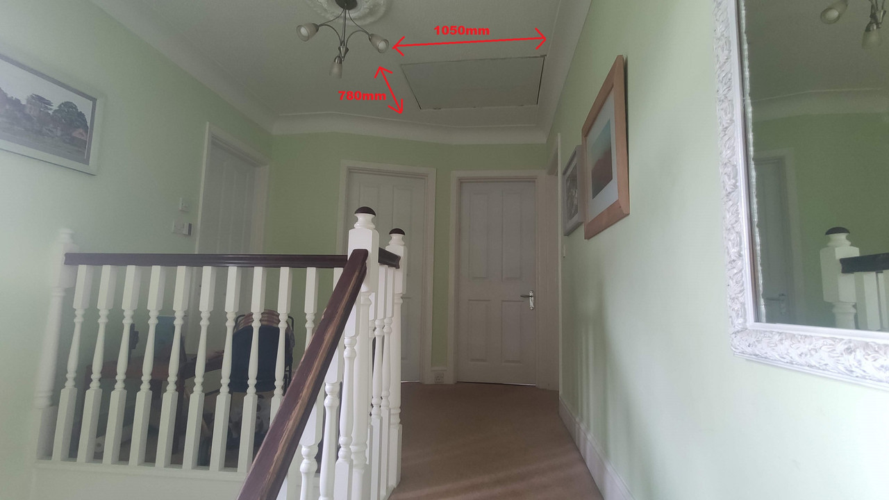

The upstairs landing with the size of the hatchway shown. The hatchway is quite narrow to fit between the beams.
The hatch open with the current 'too steep' and painful to stand on ladder

I would like some steps that go up the same direction as the new ladder but cannot find any commercial ones that are narrow enough to fit. Any suggestions or plans welcome.

Nothing from LaddersAndScaffolding fits the aperture unfortunately. I was going to cut and narrow an available loft ladder but then all of the fittings don't, er, fit

Enlarging the opening is usually pretty easy. The joists don't usually go very far unsupported on a landing. Well worth doing to get a decent ladder and make it easier to get in and out.

The one in Nicks post above is the right width to fit nicely between the joists so as long as you alight it in line there should be no reason to start messing around with joists.

Zippy - had seen those and tried to work out if we could do something like that but when against the wall treads go up above ceiling height - plus the small question of doors.
Might look at enlarging the aperture but it is a lot of work for a small gain.
