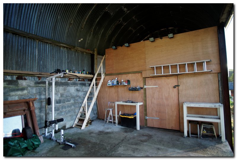

Posts: 151
That's similar to my DIY barn doors
Hardwood ply with left over decking boards screwed/glued to it:
And... the 'workshop' door was similar. Two sheets of ply sandwiching a 2x4 frame. Very stiff construction.
