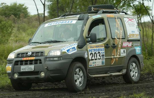

Posts: 7127
As an owner of a Doblo camper who lives in a floody area, I think I need to check this out.
Time to start modding
