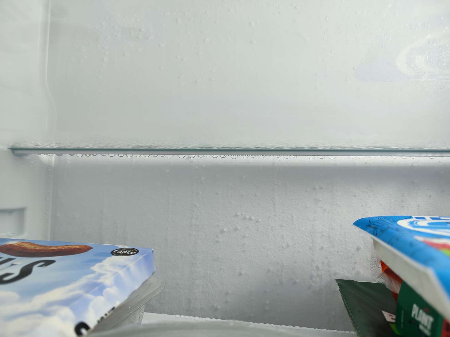

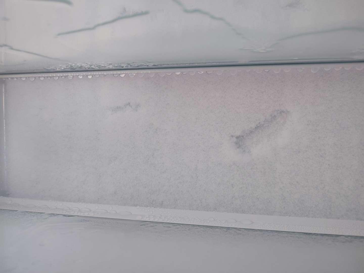

as some of you may know we're in the process of getting a new kitchen fitted.  bought our appliances separately from marks electricals which seem to have a decent rep and reviews.
the units were fitted over the weekend and fridge freezer left for a while then switched on.  after a few hours we put the food in it.
we've noticed tho a fair bit of frost on the back wall.
this is how it looks after ive wiped my finger through it to show how deep it is.
i went onto AEG live chat to ask about it and they said no, it shouldnt be like that.  looked at all the possibilities they suggested but none were relevant, so i did as they suggested and switched off for a few hours, then switched on last night and left it overnight.
frost was back this morning.
looked at it an hour or so later and frost looked to have gone but replaced by a few drops of ice.
now that would probably be more what id expect, but we're just aware that it keeps getting this deep frost at the back when it shouldnt. so, oh singletrack fridge freezer experts, do you think its faulty?
ive reported it to the seller and awaiting a reply.
thanks
It's either an installation problem or it's faulty.
You can check the installation against the paperwork that came with the fridge, if all of the packaging was removed and clearances, ventilation, etc are correct then it can only be the fridge

I guess it's integrated with a kitchen door unit on the front.
Has the door been fitted correctly so it seals fully? If not, it might be a build up of moisture from air getting in that is then freezing. Do you get a decent pull of resistance when opening the door, that normally shows the door has sealed/closed correctly. I know integrated appliances require quite accurate installation/set-up to make sure the door fits & closes correctly.
Alternatively, when fridge/freezers are first turned on, the can go into a 'fast freeze' mode to get the temp down. This might cause the symptoms you are seeing until the entire fridge gets down to temperature & the thermostat starts to control more 'normally'.
I'd perhaps give it a day or so & see if it settles down. Try not to open & close the door just to check, as this introduces moist air back into the fridge.
Finally, does the appliance have the correct ventilation? Normally integrated fridge/freezers need a plinth vent to ensure adequate airflow.

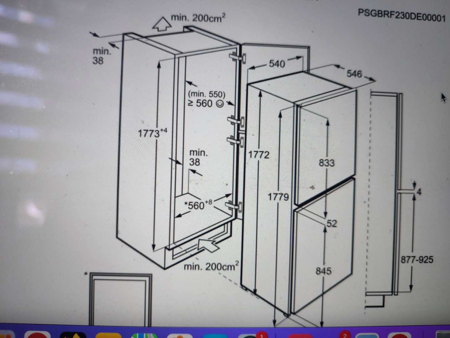

sadexpunk - regarding the vent in the plinth - the installation manual should say whether one needs to be installed. Normally on a fridge and/or freezer you would need one and the instructions generally state the x-sec area that it should cover. There will be a manual on the AEG website if you can't find a copy.
See here: AEG Integrated Freezer Example
Go to "Documents for Product" and then "Installation chart". You can see the ventilation requirements.
If the fitter has literally cut a hole  in the plinth, it will probably look a bit rough. The vent itself doesn't normally come with the unit or the appliance - although the kitchen supplier should suggest you need one if you are having an integrated appliance housing.
You can get them separately from loads of places & it will neaten things up.

all that being said - it is unlikely to be down to issue with ventilation. But, you don't want them to just hack a hole in the plinth & leave it.

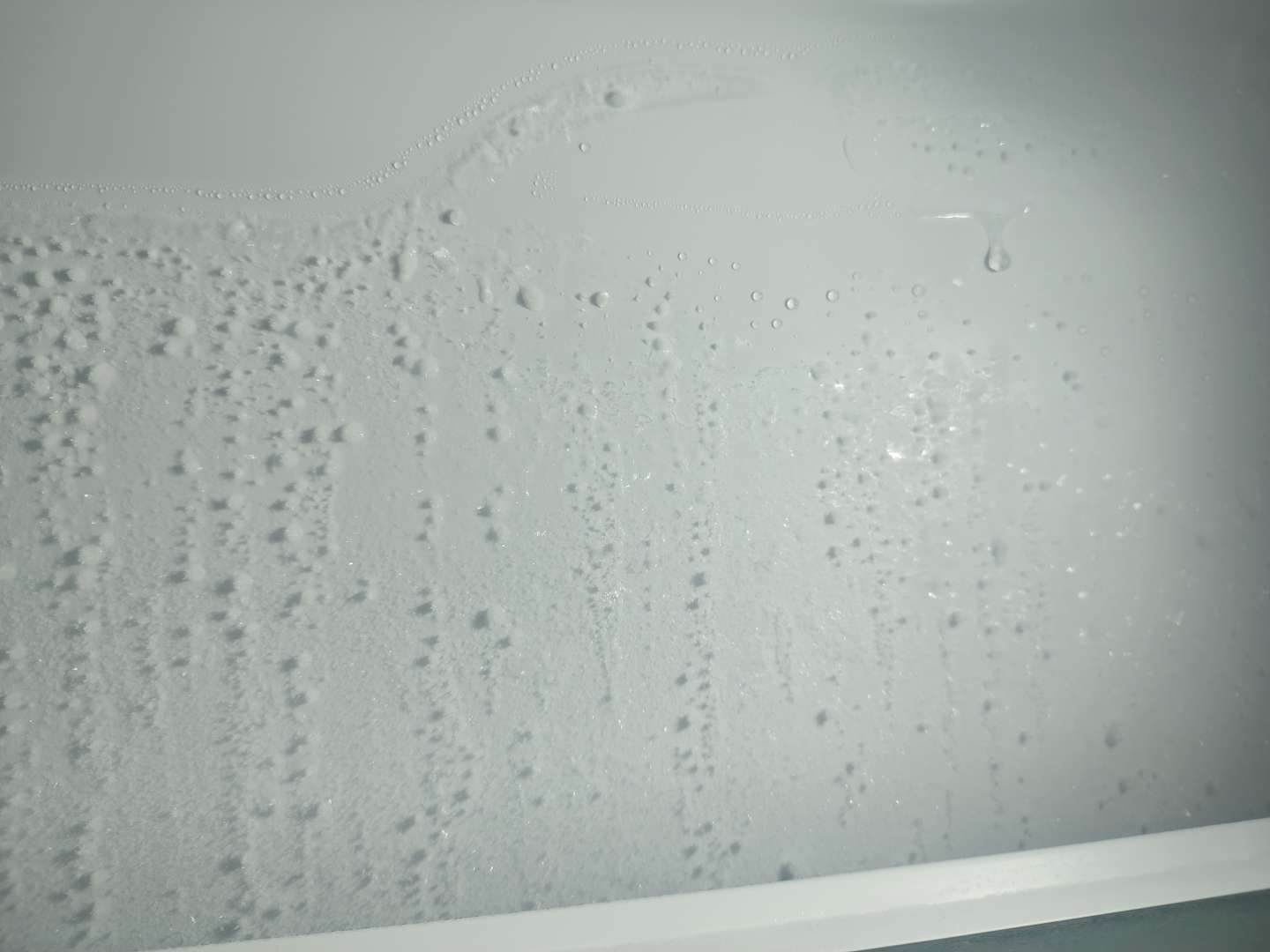

just had another look and the frost's gone, there are water droplets running down the back wall at the top (probably fairly usual then) but lower down the fridge the droplets are frozen.  no idea how normal any of this is really, but i'll obviously keep monitoring and see what marks come back with.

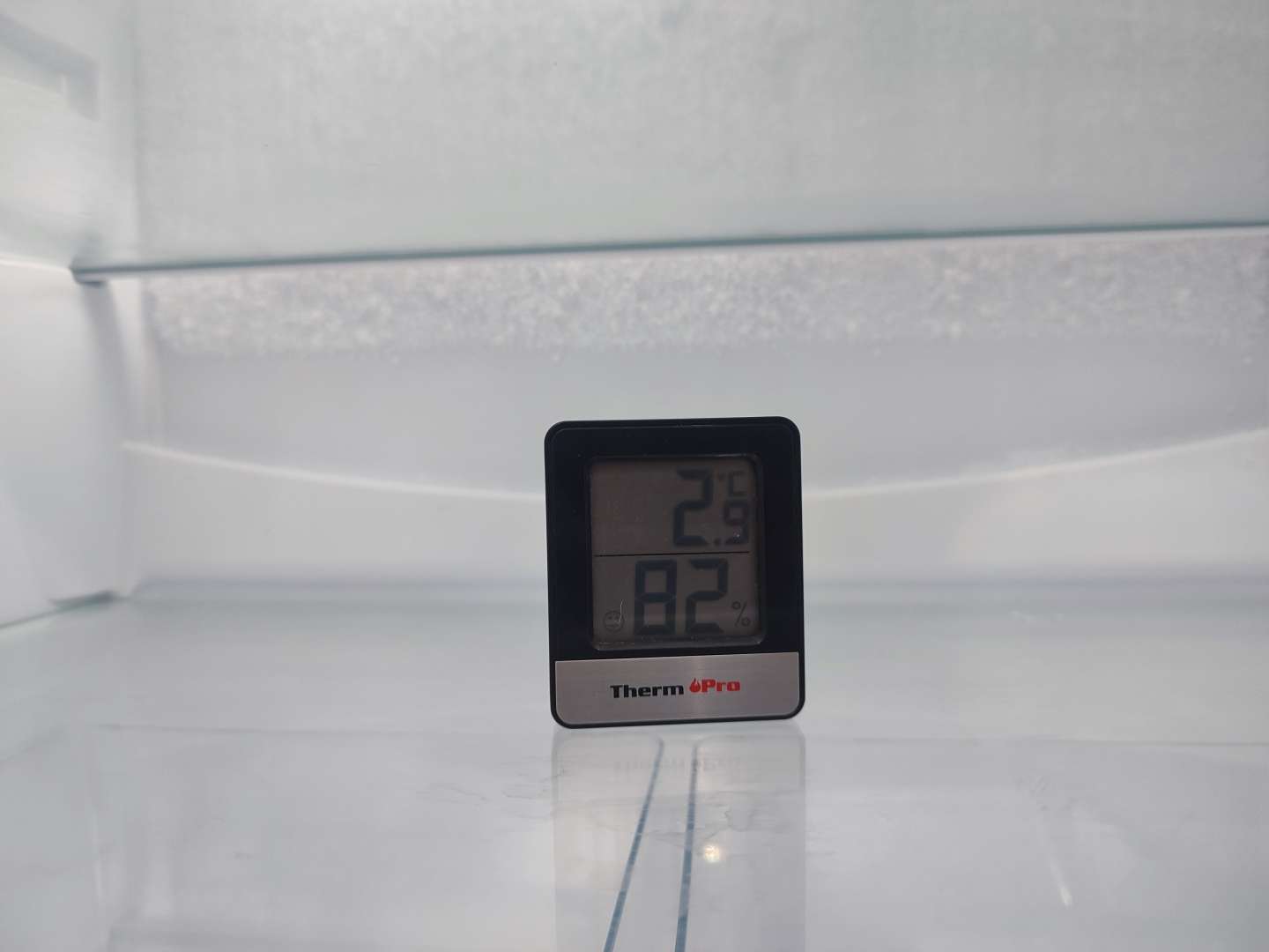

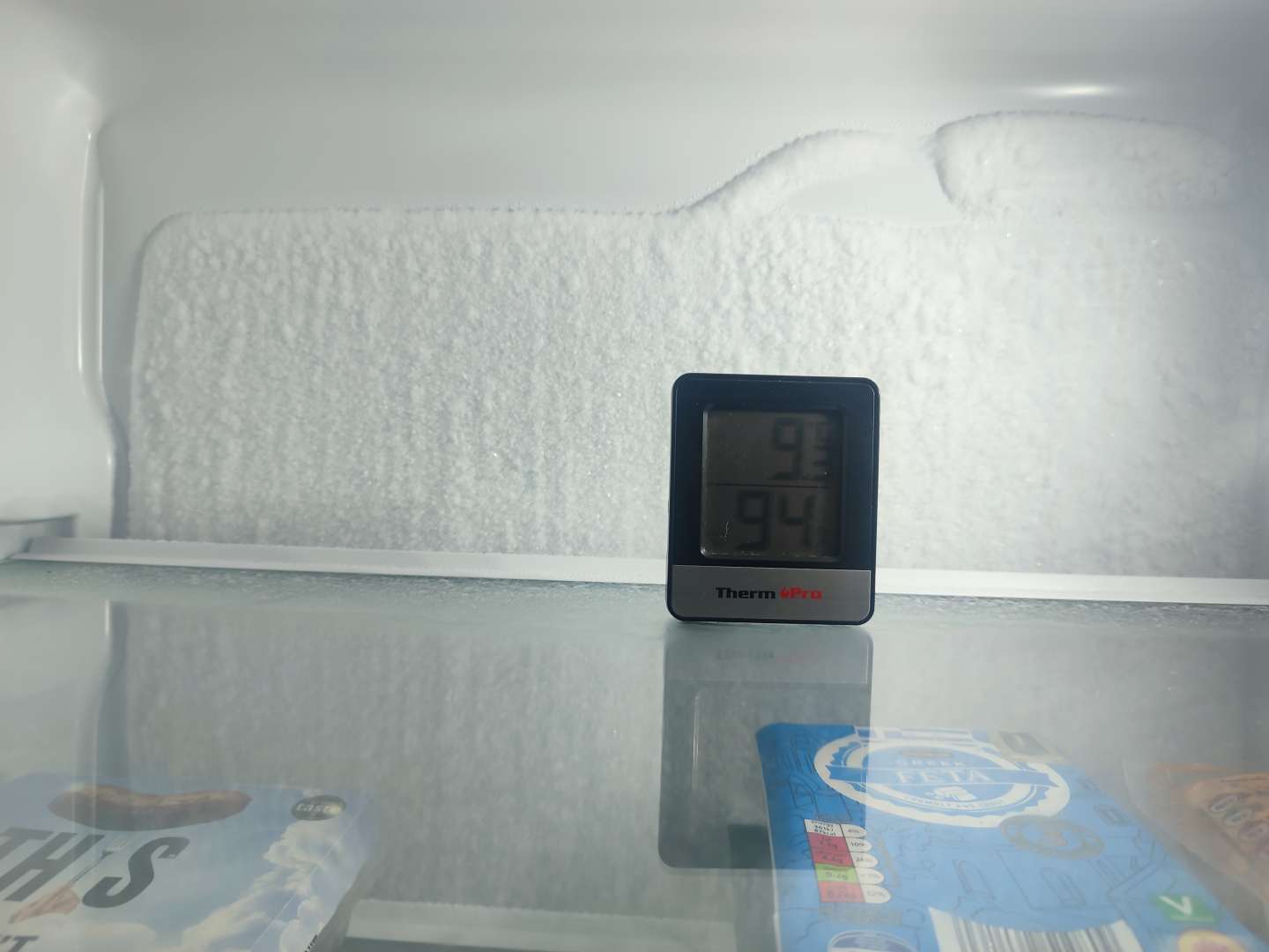

amateur sleuthing part 87...... i put a thermometer in it this morning to monitor the different heights of the fridge.  the thermostat is set to 4 degrees.  top of the fridge is 9.3, lowest shelf is 2.9.  im no expert but that would appear to be wrong.
ive had another look at the installation drawing, it all seems ok.  the appliance should just slide into the unit and a vent underneath it all in the plinth (even tho there is a front vent on appliance that doesnt vent to anywhere.

the thermostat is set to 4 degrees.  top of the fridge is 2.9, lowest shelf is 9.3.  im no expert but that would appear to be wrong.
See my previous post, sounds similar to our AEG. I don't think ours is faulty, just not very good.
sorry, not that it really matters but i did a ninja edit.  got my top and bottom mixed up, top is 9.3, bottom is 2.9.

You're leaking air somewhere round the door.  The moisture to form that buildup isn't coming from nowhere...
Posted : 10/09/2025 7:45 am
Posts: 2158
Exactly and the same thing with the vastly different temperatures.  Over time the temperature should pretty much equalise, if it's not, then it's likely room temp air is getting into it somewhere.
If the 'experienced fitters' are anything like the guys who fitted mine,  they got the door working enough that it didn't catch and no more.  I had to fiddle with both the alignment of the fridge itself and the door quite a bit to get it lined up exactly.

latest update.... frost has disappeared to be replaced by thin layer of solid ice droplets on back wall, however each tray has droplets dripping down, missing the drain and just soaking the tray underneath.
