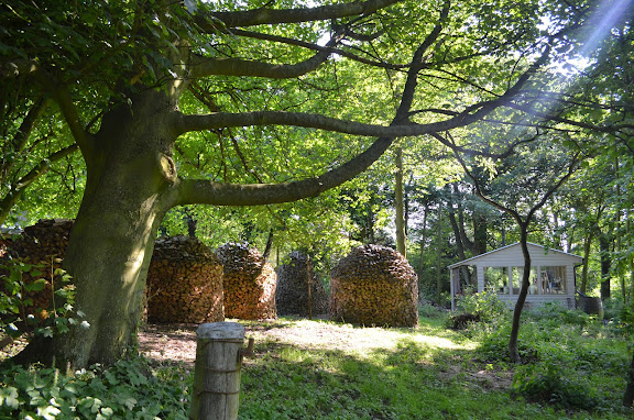

This is from summer before last. It will have done 2+ a bit seasons by the time it's all gone. It's probably around 30-40m3, but since it's all soft poplar that's not much help for comparison.

This is about a weeks worth of 5 to 11 heating.What's shown is cut up on site, then split at home. Stored on-site in log stores, so ready to burn.
