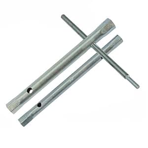

It sits under the sink just beneath the tap, and it's way up there and recessed in so you can't get a spanner to it. There's a pipe running through it (for the water, obvs) so you can't use a socket wrench. So what's the secret? Isthere some kind of special pumbing spanner?

depends which nut youre on about.
Tap Spanner is a thing
as are long box spanners for the tails

you've pretty well answered your own question - is there some kind of special spanner for taps - yup. You'll never guess what it is called...

Yes, you need a set of box spanners.
They are not expensive.

Thanks all, I'll head out and see if I can get myself a tap spanner! 🙂

Some jobs you can bodge tools for, fitting taps (or in fact removing them) is not one of them! Tap spanners FTW
[missing out on a great opportunity to get you to buy all sorts of random tools, e.g stubby big headed spanners]

When I did our bath, I found a 32mm deep socket fitted over the protruding pipe just enough.

Sometimes it's a lot easier to take the sink out, change the taps and put it back.
