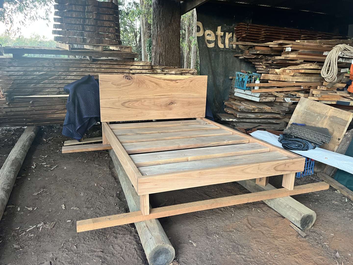

Have made a certain amount of progress... not looking like i'll be doing much making yet though.
Have a local guy that's about to relocate his mill to closer to us, and build a kiln. He made beautiful furniture for my in-laws 10 years back and rather than bring his Lucas mill in* is going to get the timber to his big mill and cut it up.
We'll get some bridge deck parts, a couple of 6.5+ beams to sell, might just slab and store most of it while we decide what to do with the rest of it.
He'll make a bed out of the trunk of the tree that took out our bedroom (and bed), a replacement outdoor table, etc.

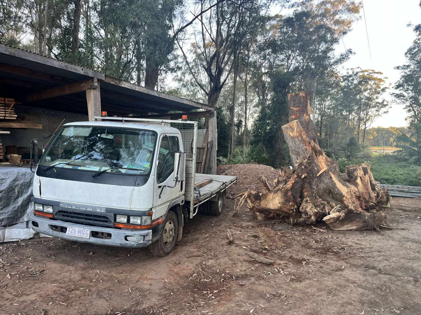

Progress is as slow as expected...
This is the base of the tree that went through the house, looking from the other end. It's about 6m long. That's going to be chopped in half and will become a new bed and integrated bedside tables.
Unfortunately, to get it out from the back of the house i've had to remove another tree. It would have to go to make way for an extension (if we ever get to the point of rebuilding the house!)
Before:
After:
The housesitters seem to be doing a good job for us at least:

Shifted the last of the house smasher on Saturday. Next job will be transporting to the mill.
https://flic.kr/p/2nMiUQf
https://flic.kr/p/2nMqj4Q
https://flic.kr/p/2nMoHDg
Posted : 18/09/2022 9:25 pm

Quite a decent pile that! Looking forward to seeing the resulting boards!
Posted : 19/09/2022 2:08 am
Posts: 9254
Some of it appears to be rotten in the center, so maybe wide boards wont be available.
Still going to end up with a usable pile of timber though.
And I'd be for cutting down a good number more surrounding the house, so this kind of this doesn't happen again.
Posted : 19/09/2022 2:23 am
Posts: 7470
That photo only shows about half. The heartwood damage not necessarily rot, but termites I think.
Most of our place is under conservation management so only dead trees get felled. Highly unlikely that a tree would fall like that, basically freak cyclonic wind, and the other big trees nearby are all pointing in the right direction fortunately.
Posted : 19/09/2022 5:59 am

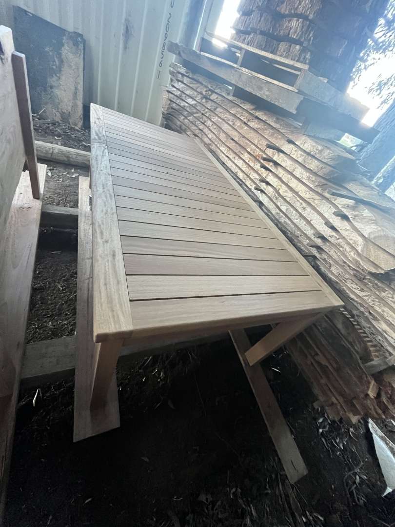

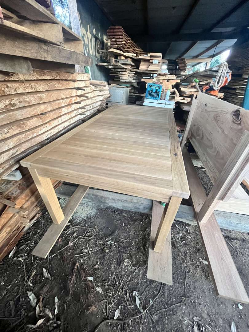

Well it's been over a year since the last update.
Furniture maker said he would deliver the next item the weekend before Xmas. But we were away. Then he was away. Then his wife had a baby. Then he had some other excuse. Next we heard it was June and he was going to deliver the weekend after we left for 6 weeks!
We got back in late July but he was too busy. Then I get a message saying he's been in hospital and won't be able to work for 3 weeks...but I can pick up from his mill.
So tonight I went and collected a bed and an outdoor table (with some difficulty due to the size of the Ute tray!)
Will need to oil it but at least we have it now!
He has some interesting projects in the wings too! IMG_1295.jpegIMG_1296.jpegIMG_1294.jpegIMG_1293.jpegIMG_1292.jpeg
Posted : 19/08/2025 11:53 am

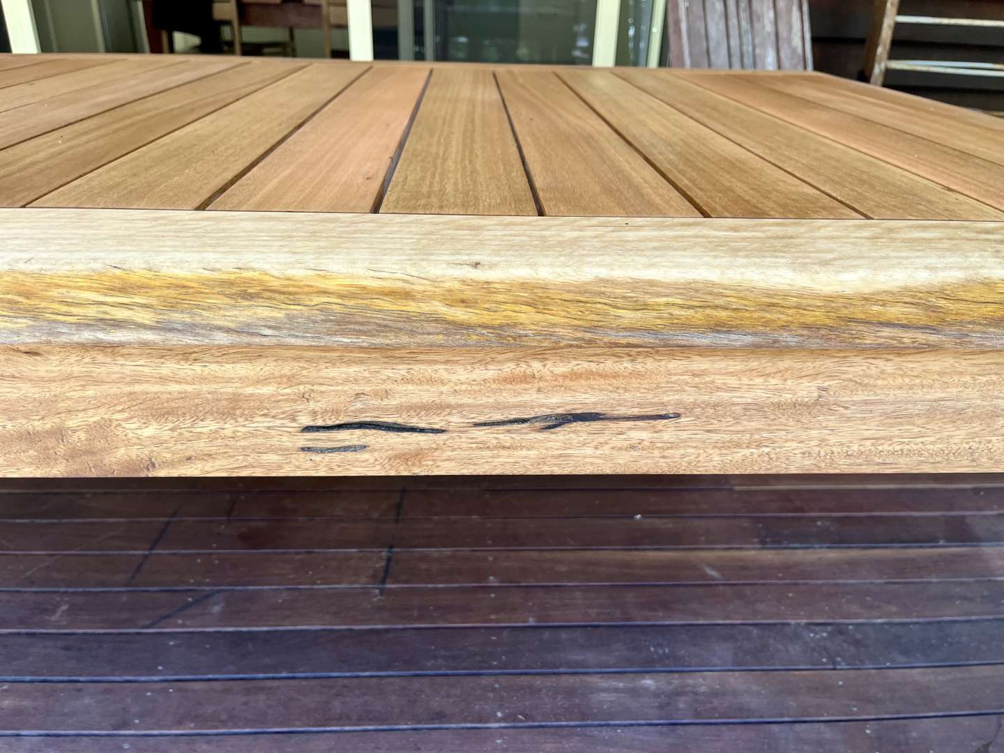

Posts: 7470
 IMG_1318.jpegIMG_1319.jpegIMG_1320.jpegIMG_1321.jpeg First coat of oil on the table and it's come up nicely.
Posted : 23/08/2025 3:40 am
