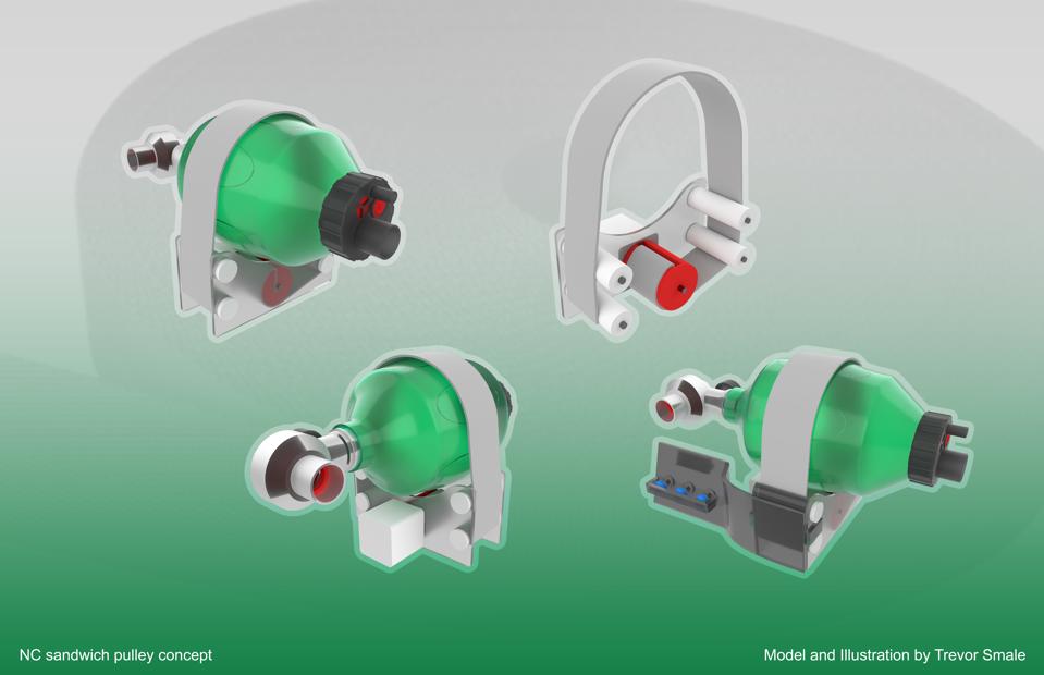

So I did a site search, and don't think this has been covered already.
I would not describe myself in an engineer in the least, but those of you here with a 3D printer and home tooling might be interested to see you could be part of the fight back;
https://www.forbes.com/sites/alexandrasternlicht/2020/03/18/theres-a-shortage-of-ventilators-for-coronavirus-patients-so-this-international-group-invented-an-open-source-alternative-thats-being-tested-next-week/?fbclid=IwAR0UGLo4UTqvxMtaaHnrWQVc2gXPE17SXniGZy-exNgY8XTPybVenS2RIlM#5dc8b88e3ba0
openlung
https://gitlab.com/TrevorSmale/OSV-OpenLung
Is the link to keep an eye on while they test it..
Interested in your thoughts?
