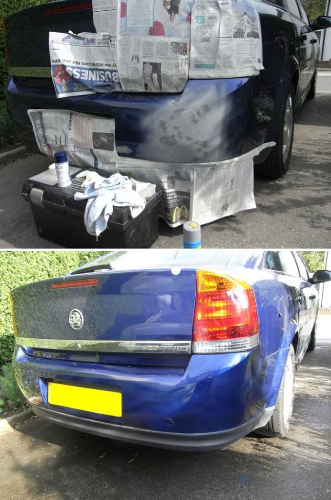

Posts: 23226
So, how did you get on?
Did mine today. £10 filler, £13 paint, 4 hours total (most of it was drying time).
Quite pleased. Not up to pro standards but the car isn't worth it.
