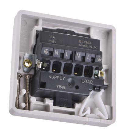

Posts: 9255
Its one of these
Posted : 23/06/2020 4:46 pm
Posts: 9255
Having further googled I now see that I should expect to find Supply and Load terminals in the back, slightly less chance of me blowing something up now
Posted : 23/06/2020 4:55 pm
Posts: 926
Cut the plug top off the tv lead and strip back approx 75mm of the outer sheath.
Turn the power off at the consumer unit.
Take the SFS off and note the connections in the back. There will be four connections ignoring the Earth ones, a L & N for supply and a L & N for load. The existing house wiring will be/should be wired into 'supply', your tv connects to the 'load' terminals.
Make sure the fuse is approx 5A, they come with a 13A as standard which is a tad too high for the tv.
Et voila!
like this?
Posted : 23/06/2020 5:03 pm

Posts: 6847
The fact you're having to ask scares me, yes follow the guide, brown is live, blue is neutral, earth yellow and green (TV may not have an earth), yes swap the fuse to the one from the plug. Make sure the outer sheath of the TV cable is gripped by the cable clamp, not the inner cables.
