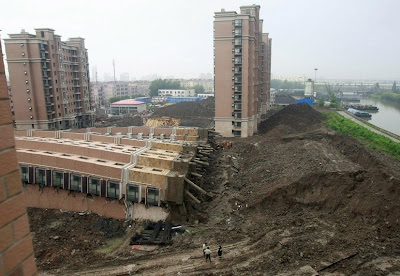

Just googled the story behind that picture Effinsafety. Blimey! I wouldn't be too happy if I'd bought a flat in one of those other blocks.
I know! What a balls-up. A life lost as well. 🙁 At $2100 a square metre (so, roughly £70,000 for a tiny one bed flat by my shonky estimation, I imagine that might be quite expensive in China)), you'd perhaps at least want something that stayed upright.
And when you think this kind of corner-cutting and shonkiness is endemic in the Chinese construction industry... 😯

Fascinated by the fallen flats - links?
Can't be too bad - didn't disintegrate when they fell. Need to shoot the guy who did the piling though 🙂
Posted : 14/09/2010 4:02 pm
Here you go epicyclo:
http://english.aljazeera.net/news/asia-pacific/2009/06/200962945745547377.html
