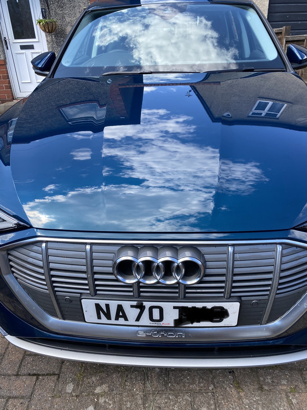

Managed a coat on nearly all panels this afternoon while it clouded a little. Need to spend some time around the grill removing the wildlife before doing that. I need practice with the clay bar too. However, it’s come up good.
[img]
[/img]
[img]
[/img]
Posted : 05/06/2021 2:34 pm
Posts: 17773
Looking good!
Did you use a lubricant with the clay?
I just use heavily watered down car shampoo. Amazing what the clay pulls out!
Posted : 05/06/2021 2:59 pm
Posts: 50463
No, just water I might try that next time. Yeah it’s a colour that really stands out. Thanks.
Posted : 05/06/2021 3:34 pm
