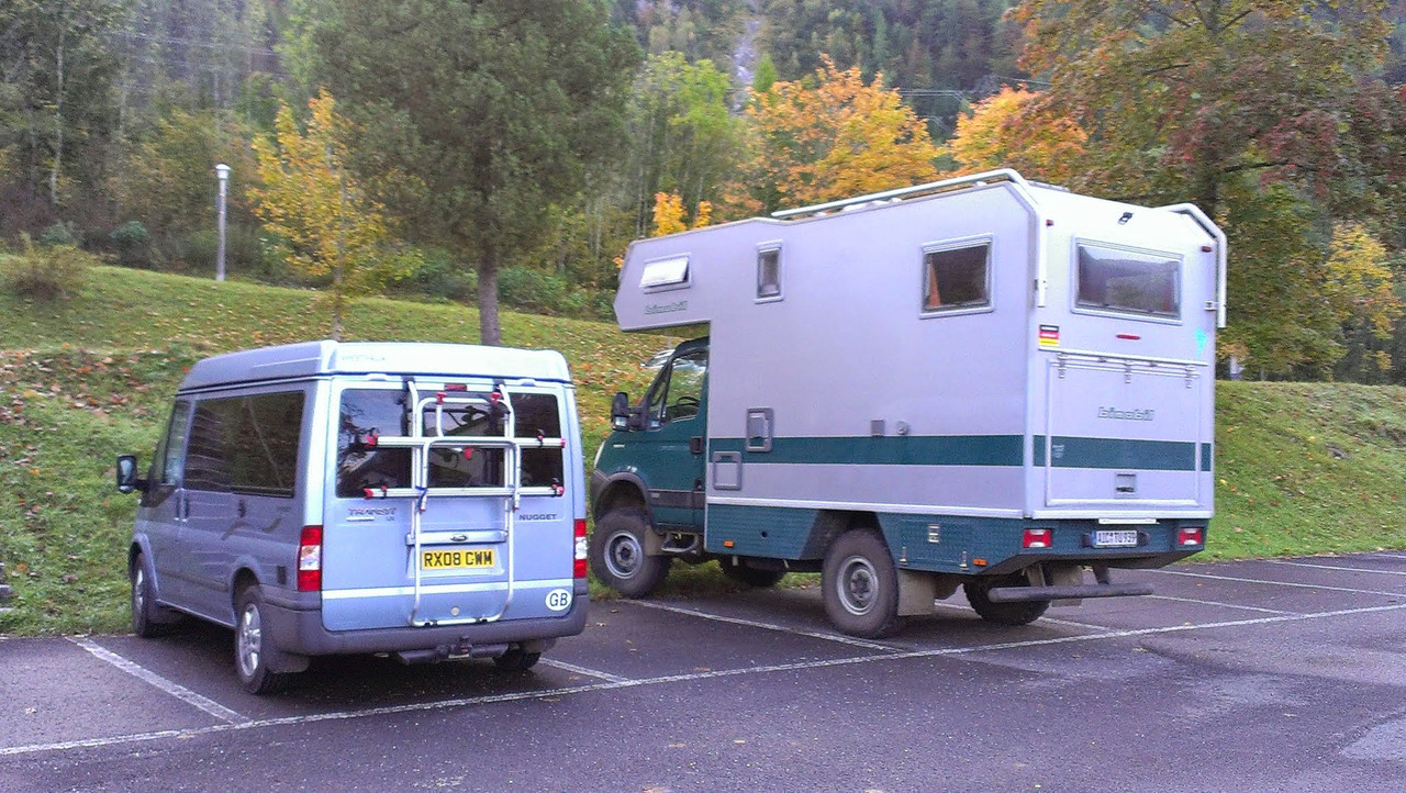

Here's an Iveco unit next to our Westfalia Transit camper in Mittenwald in October 2014 (sadly our van got nicked after that holiday..  😢)
