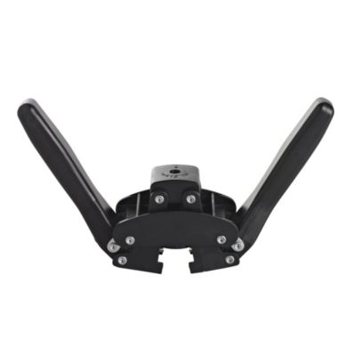

Am feeling happy with my purchase today
[img] http://lakelandcamel.scene7.com/is/image/LakelandCamel/52223_1?$280$ [/img]
From Lakeland, tidy little bottle capper.
Posted : 01/03/2014 9:18 pm

flashy, those things are a must! The supplied capper is a disaster waiting to happen IMO, the proper capper makes things so much easier and safer.
Indeed, but in the interest of costs, you can see where Steve was going with the included one.
I'm interested to see if he comes up with any new variants on the kit for Christmas. Such as a 'deluxe' version, with a proper capper etc, for example.
Posted : 02/03/2014 6:56 pm
Oh absolutely, it wasn't so much a dig at the supplied capper other than highlighting the huge improvement the other capper makes to the bottling. The massive brewery kit is great in that it provides you with (almost) everything you need to brew good beer, which gives you the experience you need to make educated decisions about upgrades.
I did find that capper quite tricky to use though, but i suppose it would improve with practice.
In all honesty, I think the kit is nearing perfect for new brewers. The price point and small pack size are great and get rid of all the "cons" normally associated with starting brewing. Plus, with such a low cost you don't mind upgrading later.
Posted : 02/03/2014 7:52 pm
I've got a bench capper from BrewUK, brilliant bit of kit and happy that i made the right choice to spend a bit more first time round. Makes bottling a 1 man job and i could cap 40 bottles in a few minutes no probs.
