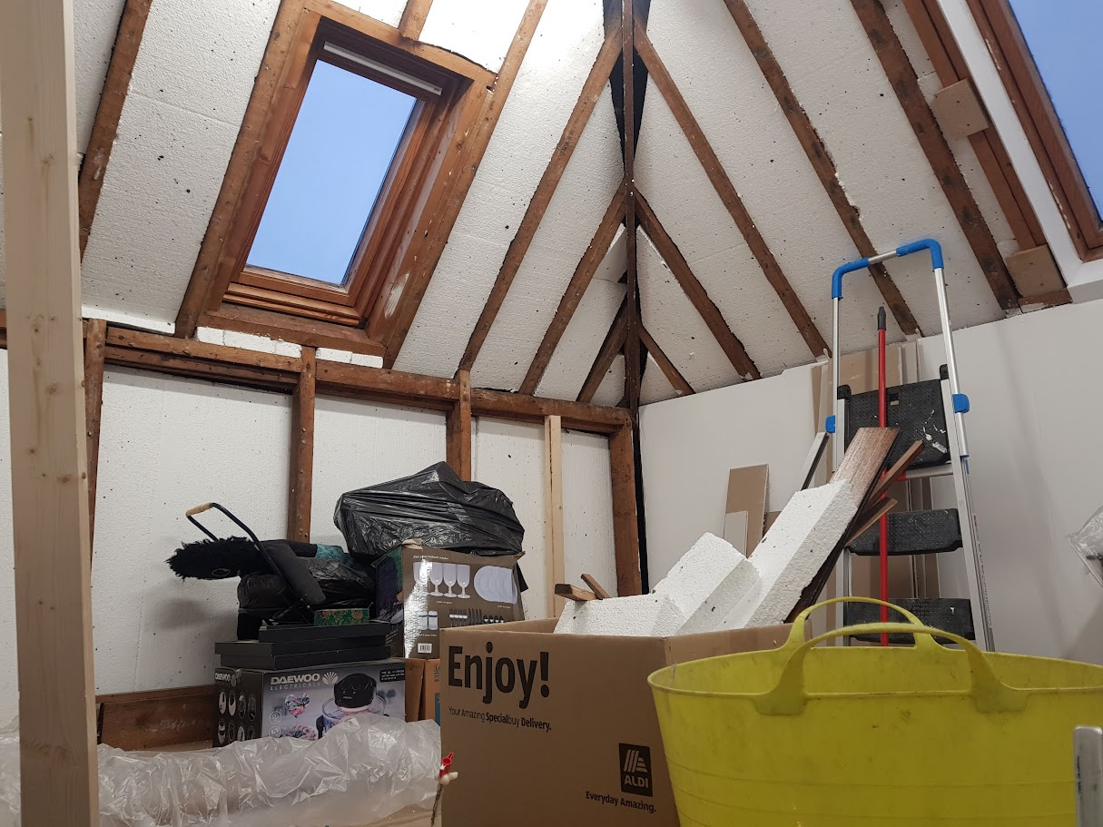

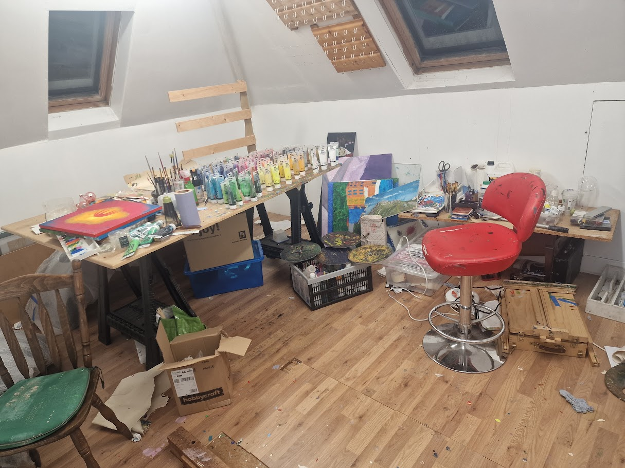

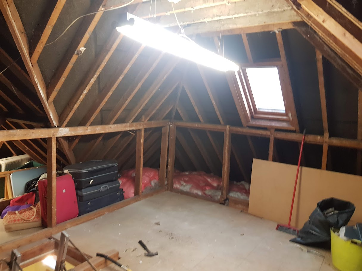

Pink insulation down on the floor, including the area under the bit. You can see we've put the loft boards down.
This is the same as normal insulation in the attic. We then put boards up the wall with polystyrene insulation filling the gap between the back of the tiles and the edge of the roof joists.
We were lucky as we already had two Velux in there. But plasterboard over the insulation, and you have an art studio.
It's not hot, but a simple air heater keeps the place fine for painting. In the summer, it's actually nicely cool all over the Velux window. Job done. Oh! We also put some flooring down because it was cheap.
Nothing technically challenging.
  • You nail the floor panels down
  • You nail the plasterboard up
  • You slot the laminate flooring together
  • We put some lining paper over the + boards just to cover the seams
Posted : 09/02/2026 11:53 pm
