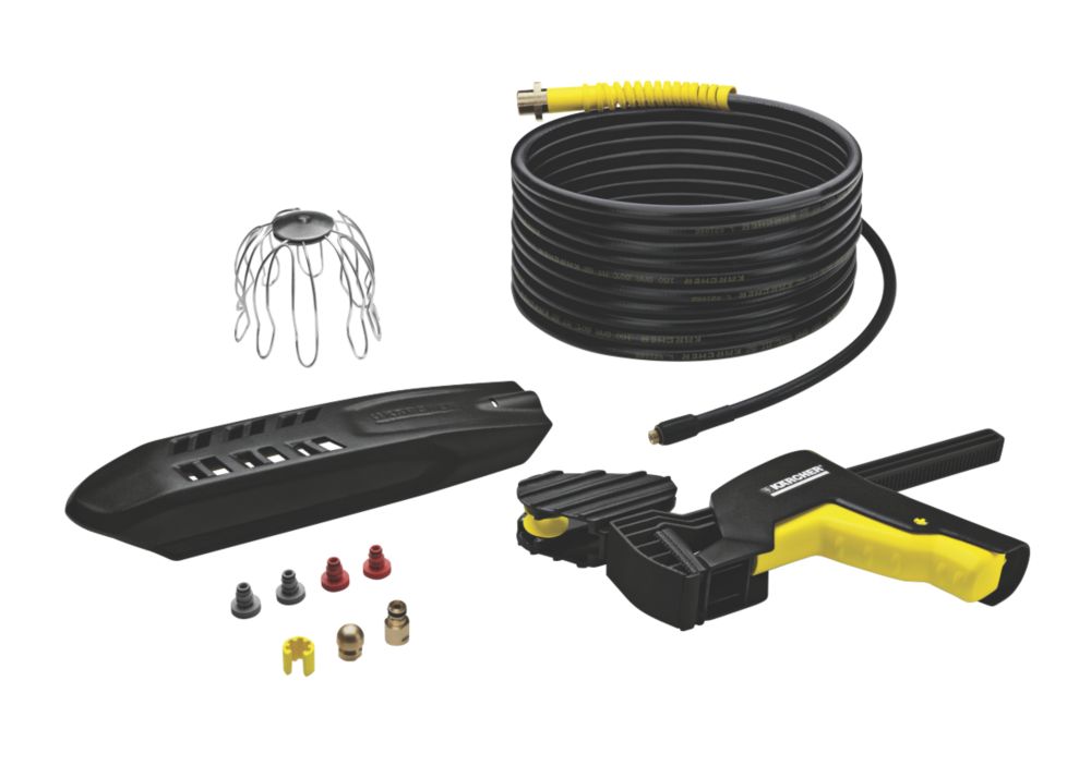

There is this bad boy (I have a pressure washer) that I was considering, but want to try to do it manually first if I can
http://www.screwfix.com/p/karcher-drain-gutter-cleaning-kit/91778
[img] http://s7g3.scene7.com/is/image/ae235?$p$&layer=0&size=281,281&layer=1&size=281,281&src=ae235/91778_P [/img]

[i]WOOOSH! [/i]
the biggest danger with this approach is blow-back.
I knew some people in a rented house in Bristol where the entire bathroom got pebble dashed after some cowboy though he could clear a collapsed drain by turning the pressure on his new bit of drain clearing kit right up. They even had to hose the roof down where it came put the top of the soil pipe.
