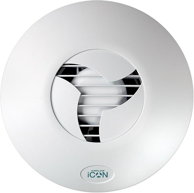

Our current one has died, so looking at replacing it....
The Airflow Icon 30 looks very good, I like the way it closes up as we get quite a lot of wind against the wall it will be in and often get a cold back draught from the existing one (the self closing vanes on the outside are next to useless as just rely on gravity).
Any have any experience of them?

Not that exact one but have fitted similar and they are generally good but sometimes the mechanism for the closure do stop working.

Yes, had one of those Airflows for about 12 years in the downstairs WC, it does the job; not too noisy, keeps bathroom smells out of the hall and doesn't admit drafts when it's closed. It takes a minute or so for the bimetallic strip to warm up and open the flaps and every year or so I take off the cover and vacuum it to remove dust.

I have two of those and had to remove the blades that make up the closing mechanism as they wouldn’t open anymore. This it was due condensation as they are mounted on the ceiling as oppose to an outside wall.
Anyone know if I should fit a condensation trap on the ventilation pipe in the attic space?

^^^^^ The Melrose every time. Ours packed up two weeks ago after five years of daily abuse in our en suite (my wife is half warm-water mermaid). Ten minutes later and just using a single cross-head screwdriver to undo the coupling device for the vent pipe, a quick clean around the blades and it is working again. Quickest DIY job in history.
