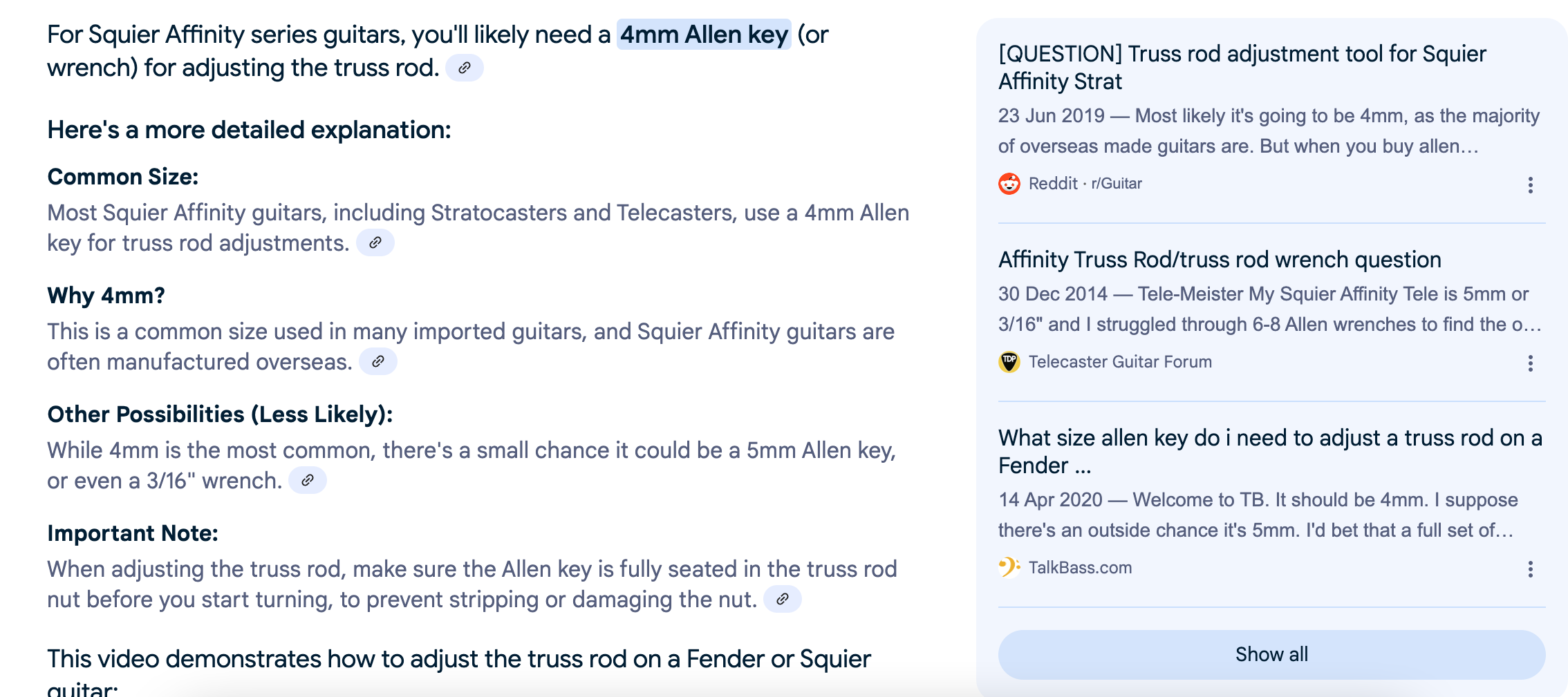

was just thinking, 3/16" is bigger than 4mm isnt it, 0.188 vs 0.157?  thought id have a quick look and as i expected, a 3/16 wont fit into the slot.  4mm was tight and took some doing, thats what made me wonder how a bigger key would fit.  it doesnt.  could squier be metric against fenders imperial maybe?
just following this up and google implies that 4mm is indeed correct.  i certainly couldnt fit the 3/16th key in.

My inner wince is still going after your report that the allen key was hard to remove. It is vital you seat it correctly, as it's so easy to damage or round off the head of the truss rod nut, and there's a lot of expense and faff to repair/replace it. I might even suggest you invest in a ball-end version.
If I might make so bold, 50 quid sounds like a lot of money, but it would be totally worth it, and a lot less than the cost of replacing a truss rod......
im pretty sure it seats correctly, its just difficult to remove once turned.  im not sure if it might be because its then pushed against the A string which is applying pressure.  my mates going to give me some feeler gauges, so when i get those ill have a proper measure and hopefully it wont need tweaking again.
