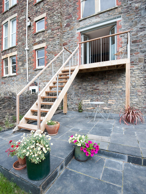

This sort of thing:
The back of our house is 3 storeys high with the dining room backing out on the 1st floor. I'd like to build a balcony which looks out over the garden and has steps down to it. Nothing massive, just an area where I can put a small chair set on.
I know I'll need planning permission.
I don't fancy a wood one as it'll need constant upkeep and end up looking shoddy. I've had a look at companies that can make them for me but the cost is crazy.
Could I get a structural engineer to spec me a steel frame for the platform/legs and stairs to be made out of steel?
Any ideas or experience welcome.

you're on the right track from my experience, planning permission (get pre-planning advice first so you don't waste time), structural engineers design for steel frame/stairs (there are specific strength requirements in building control which I don't have to hand but you should be able to find them on your council site) then phone around fabricators...

Are you saying you would weld up the steel sections yourself? If not you would still have to pay someone to fabricate it for you so you're back into the "companies that can make them for me but the cost is crazy" territory and you would have some guarantee with them on the structure, whereas none from a welder.
I don't think you need planning permission for something that small and TBH it would be a safety enhancement.

Not if it was constructed poorly! I'm fairly sure building control (and probably planning due to the height) would want to speak to you if you just chucked a balcony up.

Overlooking your neighbours will be the issue for planning permission.

It will be constructed properly with the appropriate permissions. I have already spoken to my neighbours who wouldn't have a problem with it and loads of houses along the street have one already so there is a strong precedent set already.
The big priced balconies are normally because firms offer a bespoke service designing/manufacturing/installing them. I don't want a complex one or a designer one and can do a lot of work myself or employ my builder for x days if professional help needed.

The money is generally in the staircase / balustrading.
Firstly, decide what you want visually, then drop me an email with sizes / heights etc and I can give you a rough idea of what you should be paying.
if you go to a structural engineer with some drawings , you can keep that cost to a minimum .

I have designed a few in the past when I designed houses. I now design structural steelwork and if I was doing one now I reckon I would do it all in laser cut parts so anyone could go to a laser cutters and self build it. Drop me an email if you want to discuss it further

Just make sure who ever makes the "structural" part is CE certified . i.e BS EN 1090.
This would refer to the balcony / platform / legs and the staircase. The balustrading is not covered by BS EN 1090
I quite often get smaller workshops to do my balustrading and get the big boys to do the heavy stuff.
