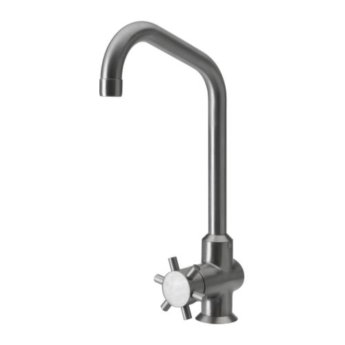

DO NOT under ANY circumstances get this tap unless you want mild irritation on a daily basis

Bedmaker, whats the problem with that tap? We quite fancied that one!

tw - I have that tap in the utility room. Its a bit crap, the tap action (tilt and twist) on the valve is not particularly dexterous, also the spout is not particularly solid in the mount and is tall so theres a lot of leverage.
The tap I have in the kitchen on the other hand is excellent. I think it was even druidh that identified it for me 2 yrs ago when I put a pic up of it from a mates house (they didnt know where it came from).
unfortunately I cant find it on the ikea site...

We also got bedmaker's tap and find it a pain as per his explanation.
