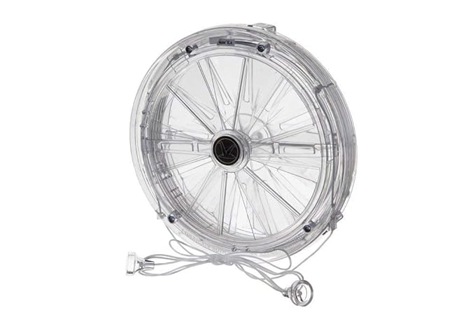

Posts: 14227
Whack a few of these in for the classy option...
