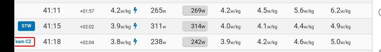

For comparison this is last nights ZHR, the three in the image are all cat C, that's me in the middle.
There's a big difference between power but relatively little time.
I'll let others decide if volcano climb is a flat or hilly route
Posted : 09/06/2020 2:32 pm

Volcano climb is flat. Climb not steep enough or long enough to unship C cat races with extra weight like me compared to 70kg riders. (within Cat limits) My extra power keeps me in.
BTW the 3 of you are cheats if you were in cat C ;0)
Edit Ah I see CatD is CatC now. Makes sense...

in a 41 min race ?
Posted : 09/06/2020 2:42 pm
Posts: 1351
Yes. I may not have won the races I've done over that but it was only down to the sprint.
A Cat might be a different story but drafting is in good effect on a lot of that climb.
I've lost the wheel over the top before now and been severly punished on the downhill though.

in a 41min race
Well I wanted sub 40 but couldn't manage it.
Edit Ah I see CatD is CatC now. Makes sense…
Ah, yes, they had us all down a category, so I race B but was in C for whatever reason.
Not with no draft its not 😢
