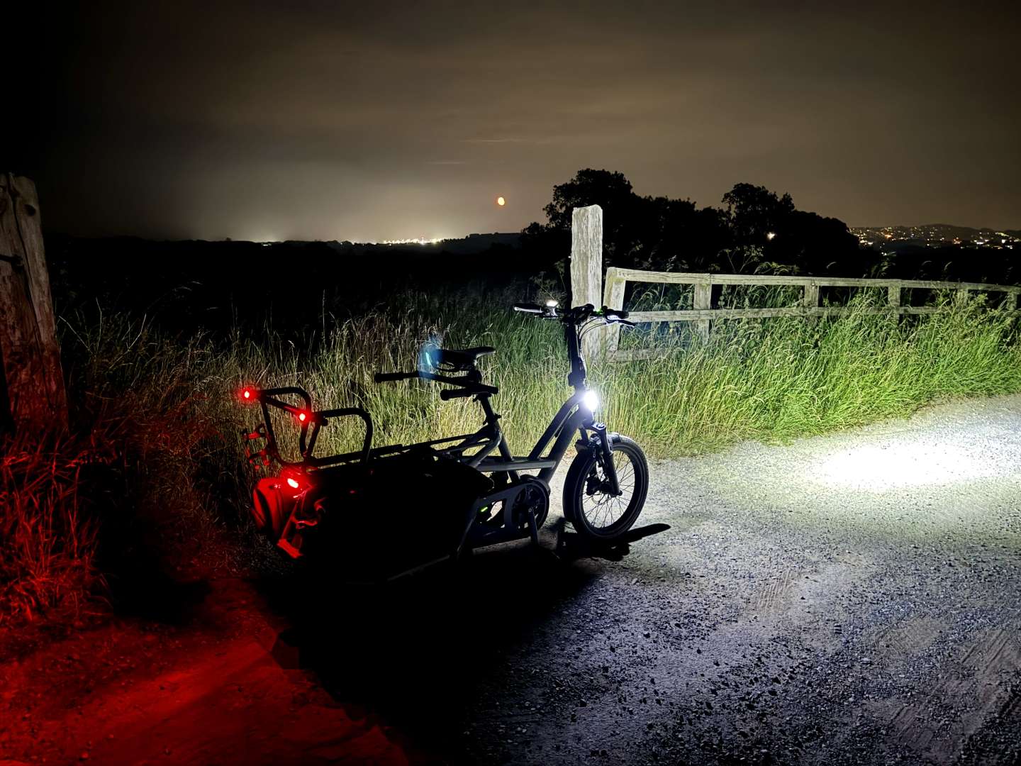

Posts: 3334
We also have a multi tinker, 2 yrs and 3000miles now doing only trips within 6km of the house mostly, transporting kids (and the occasional small adult - looking at you Fabian), shopping, bikes and general carryshit olympics stuff.
NOTE: whilst it is possible to fit a bag of cement and large sack of gravel in one pannier, it is much more sensible to distribute the weight across both to avoid turning alarmingly sharply in one direction only 🙂
Granted I am a big fella, but any adult on the front will take most of the wind/cold/rain and shelter anyone sitting on the bench so weather is rarely an issue unless it's really cold.
Belt drive and enviolo is really a brilliant, almost maintenance free, option. Glad we got that rather than chain and mech/cassette.
2 weeks ago had our first puncture - massive slash in centre of rear tire, instant deflation (in both senses). Was not only ride ending, but given the complexity of rear hub & belt drive it was not something I could repair myself. That is one of the downsides of the belt and enviolo.
