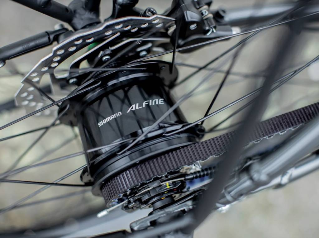

This is the rear wheel as it was built on the bike. Even with the way it's photographed, I'm pretty sure that's 3x, would you agree? Probably better to stick with that so the existing little deformations around the spoke holes are laced the same.

That looks like 3x to me - one of the crosses is very close to the hub

Yeah, that's how I saw it too. Cheers. I'll stick with the original plan then and not overdo the tension, which is one of the reason's I'm doing this - the rear was so tight it were cracking the rim around the spoke holes!
