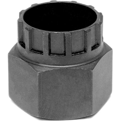

It's the end of the axle isn't it? The lock ring tool should fit as normal.
Posted : 29/11/2015 2:20 pm
older cassette tool might not fnt inside it- i have an old one that no longer works on some hubs but you dont need to remove it
this type wont fit all of mine

@Junk - so you said I *don't* need to remove it? What tool do I need that will fit inside it then?
Posted : 29/11/2015 2:37 pm
https://www.merlincycles.com/icetoolz-cassette-tool-with-guide-44498.html
I use one of these but any cassette tool you buy should fit

Yep, thats the end of the axle. All you need is a standard cassette locking tool that will fit over it (And a chain whip of course)
As an aside, anyone running a SRAM 10-42 cassette on an XD freehub body, FFS PLEASE tighten it with a torque wrench. I removed one that had been overtightened, (well, I tried to) and all the splines sheared off with a bang and left it utterly impossible to remove the cassette from the freehub body. New cassette (£240 RRP) and freehub body (£70 RRP) required.
