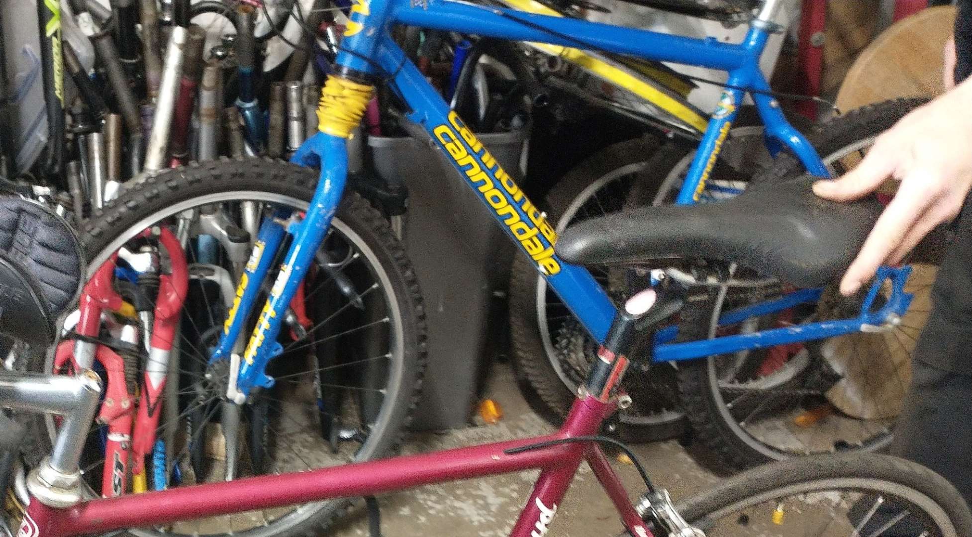

I had a chat with a bloke at my local riding spot who offered me a free Dawes galaxy tandem frame.
He works for a local bike recycle place and can't sell it as it's rusty round the bottom bracket. As it could possibly be dangerous they can't sell it, but he didn't want to see a frame that almost certainly just needs a wire brush and some hammerite go to the tip.
I went and had a look. 50 something seat tube and on that vintage of frame I'd be needing a 64cm.
Lurking at the back was a Cannondale cad 3 in Volvo Cannondale blue/ yellow with a headshock and big enough to fit me.
A quick trip to the vice to get the seat post moving and it's mine 😀
The headshock is totally solid and they said they would get it working for £50.
I had a lefty ona scalpel 15 years ago and it was £££ getting anything Cannondale serviced then. Some of the lefty's the specialists were not interested in.
So I'm not expecting 80mm of plush well damped goodness
Am I likely to get a complete pogo stick?
Looks like this but with paint chips aplenty

Crappy photo as I was more excited about the bike than my very bored 5 year old 😀 IMG_20250527_121325475~2.jpg

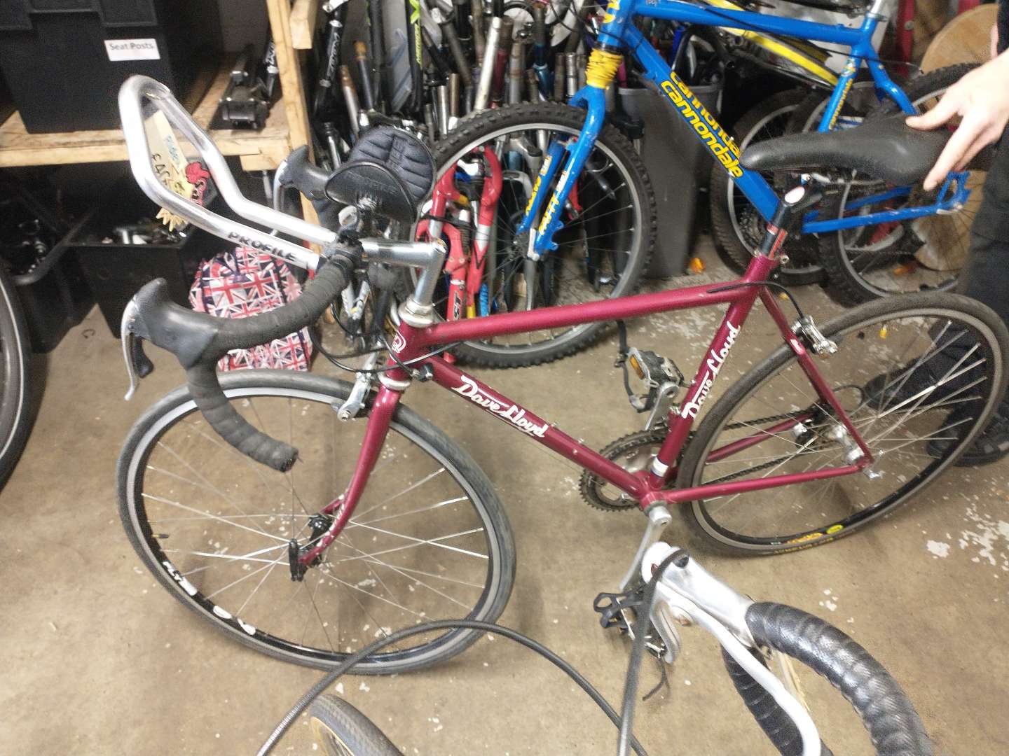

The road bike at the front of the photo looks way more interesting, and I'm not much of a roadie! What looks to be fillet brazed, wishbone stays etc.
Looks like a Dave Lloyd, maybe a Concept 90 with 650c wheels?

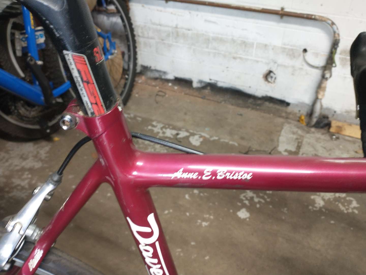

Its a tri bike from a 4 time iron man winner for a bargain. I did have a look but couldn't back up that it had won 4 iron man triathlons. I'm sure there must be some.site like roots and rain for triathlon but I couldn't find it.
I guess it's this lady's as it's got her name on it 😃
https://www.lancashiretelegraph.co.uk/sport/8194333.iron-lady-anne-shows-mettle/
https://m.facebook.com/groups/450550069015417/pos t's/1892403554830054/?view=posts
They were after £200 or £250 for it
There were all kinds of old but shiny things. They seemed keen they went to someone who would use them 😃
