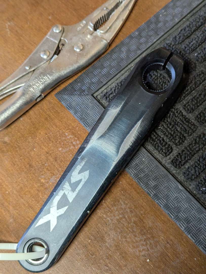

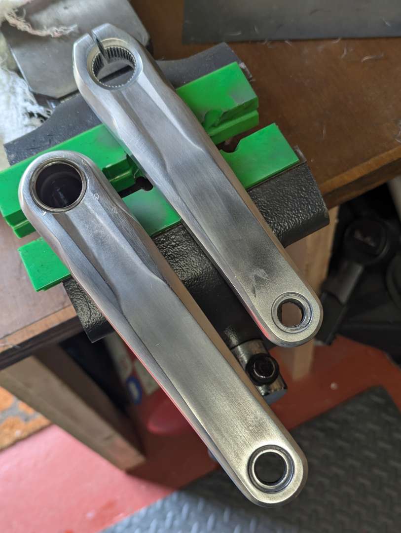

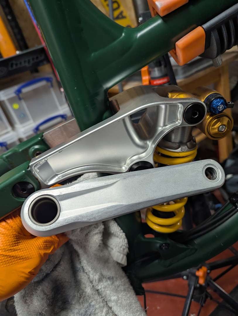

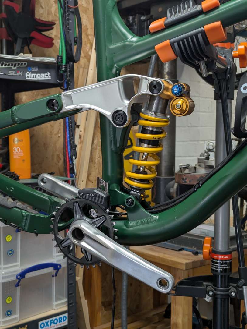

I can't afford Hope cranks yet so I've spruced up my SLX ones. They're still too long but I'm very happy with how they came out. Absolutely minimal effort.

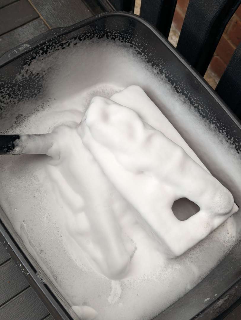

I couldn't find caustic soda in any local shops so I bought spray on 'Elbow Grease' foamy oven cleaner. Soaked the arms for about an hour then used Autosol on a polishing mop fitted to the drill.

Yeah it'll definitely oxidise pretty rapidly. I'm riding for 2 days this weekend, so we'll see how they look after that.

I use drain cleaner instead of oven cleaner so I can see it working rather than guessing  how long to leave the foam on.
