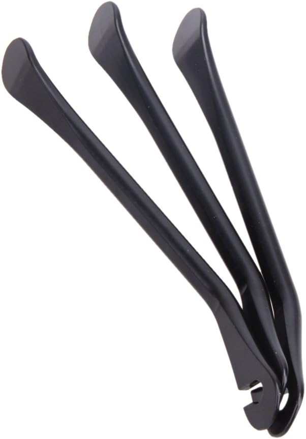

I’ve chipped a piston using the screwdriver twist method, I use a decent plastic tyre lever now

Metal tyre levers are better for pushing pistons back than a screwdriver. Use the blunted, angled end as there's no sharp edges and the bend gives you better access and leverage.

I use one of the crap "XMAS gift" plastic tyre levers to push back pistons. Obviously easier with the bleed open at one end if it is sticking though used a closed spanner carefully when its been in my hand (like for undoing the bleed valve)

I use a plastic coated metal tyre lever if I'm doing it direct on pistons.
Wouldn't buy one just for that purpose though!

Every year my mam buys me a puncture repair kit ... (despite me being tubeless on everything but the DJ and having perfectly good tyre levers) ... I got a whole load of the cheap and nasty plastic tyre levers.. and the bent bit makes them ideal for pushing in pistons. Happy to pop a couple in the post if they go in a normal letter...
