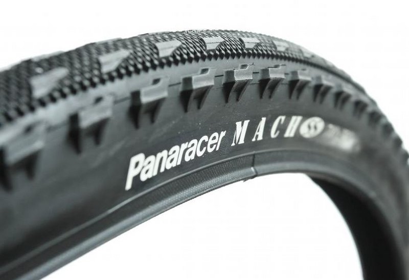

Those panaracer match are the ones i went touring on with a mix of road gravel. Great for that. Not great for wet grass in the pentlands! I’ve never locked the front wheel withany other mbt tyre -and kept accelerating! Not for long, there was a nice ditch to land in : )
