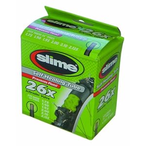

All this talk about tyre burp, topping up sealant and compatible tyres makes me wonder if going tubeless is really worth the effort. I know that this will stir up a hornets nest but it may be of interest to the OP.
I have one bike and change my tyres regularly to suit the conditions. To stop punctures I use Slime tubes
Yes Slime tubes are a heavier but so are tubeless tyres and sealant when compared to standard tyres and no sealant. The weight of the tube itself is more than a rim strip but I can change tyres when I like and haven't had a puncture for 8 months.
For me and my circumstances it is the perfect solution.
