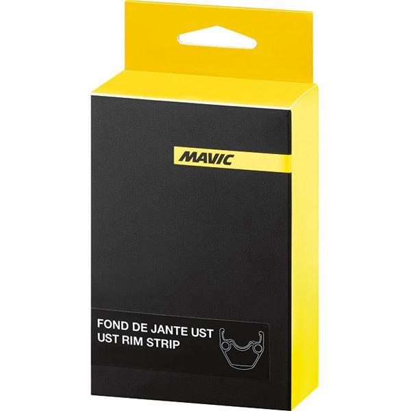

If it's a ust rim, try using a proper ust rim strip. I used to have some ust rims and they came with a rim strip rather than tape. Was super tight and worked perfectly.
https://www.bikeparts.co.uk/products/mavic-25mm-ust-tape-19-to-22mm-road-rims?

@nickc, it's not a fully sealed rim, it's one of these
https://www.sjscycles.co.uk/rims-tape/mavic-xc621-29er-622-mtb-disc-rim-black-32-hole/
I thought Mavic called all their tubeless rims UST, even the drilled ones, but I could be wrong. In any case they say to use a UST valve
@ads678, I didn't realise Mavic did rim strips. They seem to have moved to tape now, but I will have a google (my quick look now only unearther 26" strips)

That one I've linked says tape but on the pic the box says rim strip.
Pretty sure the rims I had had spoke holes, but they deff used a rim strip rather than tape.

@ads678, ah, for some reason I didn't see your link, thanks I'll check it out.

@munrobiker, exactly, and I can’t believe everyone doesn’t see it this way. I think the Bontrager strips are perhaps the best solution in the absence of rim redesign. They really are nice, but finding one that fits is a total gamble with non-Bontrager rims
Mavic got things nearly right with UST 20 years ago - a superb first go at tubeless technology. I got a set on a new bike in 2002 and they worked great - even greater after sealants started to be understood as beneficial.
They were miles ahead of everyone but they just stood still with it for years - perhaps they thought that the unavoidable weight penalty of a sealed rim could never be surmounted in marketing terms. We all appreciate that weight is massively over-played for MTBs but it remains deeply rooted in the business of selling bikes to this day.
There were other issues but they would have been overcome given sufficient development - eg the rims were narrow, the OG UST bead was a square shape so tyres were somewhat restricted etc.
