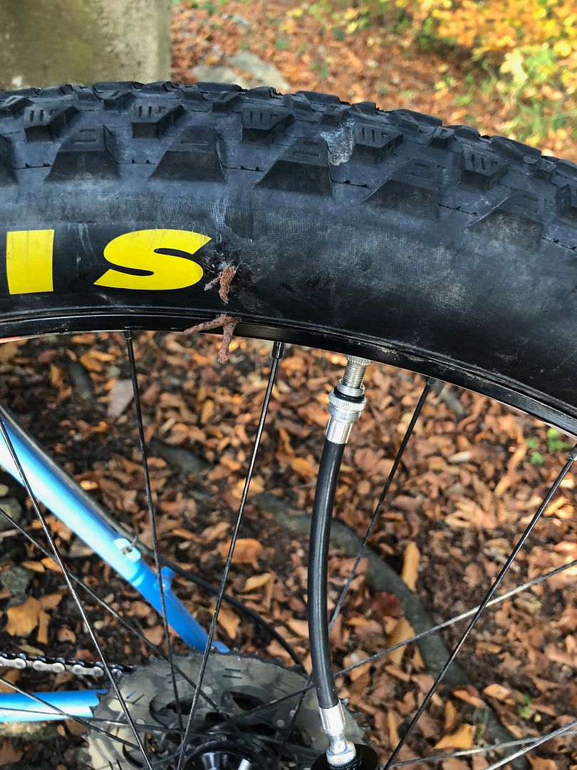

Got a cut from a nasty sea shell on the beach on the front tire, sealant just about working but it was a pretty big hole. When back at home: quick rasp, small anchovy on prong, bit of glue on the anchovy - eh voila!
And, live, as it happens updates from the trail this morning: due to not learning and still running my 29x3 chronicles at too-low pressure on my hardtail, got another nasty snakebite in the sidewall (one right down at the bead). Followed same procedure as above, but trailside, and it worked a bloody treat. Didn't lose that much air, didn't need CO2 just a few pumps.
Seems tire was also bone dry of sealant, which figures as I haven't topped it up in about a year 😳
