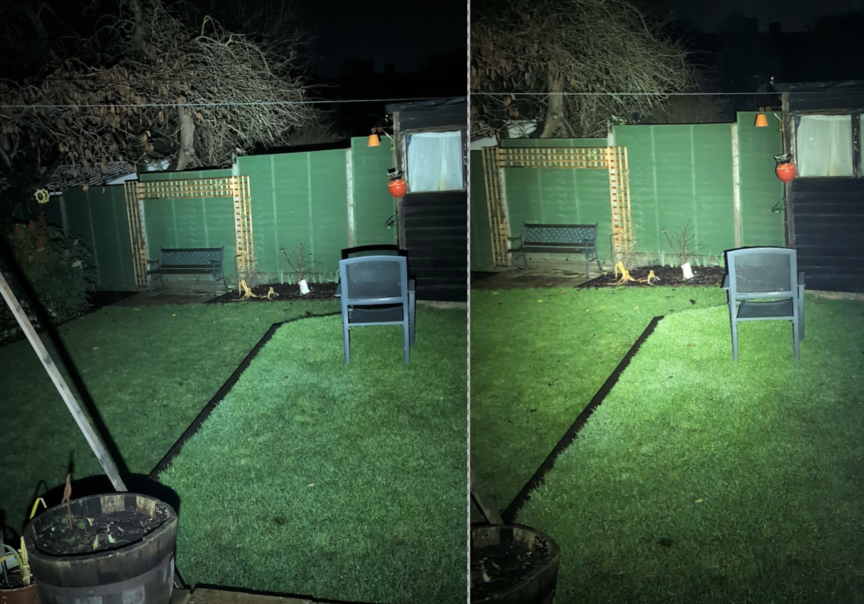

I bought one of these after seeing this thread, it arrived yesterday.
Initial thoughts are that it seems well made, and pretty bright.  I'm mainly planning to use it as a normal head torch around the house/garden/camping/etc.  I think it would work well on the bike, although as it only comes with a headband, I'm not sure how I'd mount it at the moment - as it's a Chilli-tech copy, are there any suitable mounts available for those?
I already had a 3100mah battery, so I'm using it with that - it's currently charging using the light's inbuilt charger on my desk.
Some usability notes.
  • Click to power on/off
  • Long click to change brightness (Brightest -> 2nd brightest -> etc)
  • Double-click to switch to flashing mode
  • It remembers which mode it was in when you switch it off/on.
It's not a very accurate comparison, but this shows it (Left) compared to my Joystick (Right) (I think it's an mk11, and not on it's most powerful mode), it's definitely more floody compared to the Joystick.
Posted : 05/12/2025 10:06 am
Posts: 3446
When I said the Joystick isn't on it's brightest mode, I should clarify that I have it configured to use the mode that toggles between 3hrs and 8hrs of use, and was on the brighter one of those.  It also has a 1.5hr config, but I never use that and couldn't be bothered to change to it for the photos.  In effect, I wanted to compare it with what I have on my usual rides.
Posted : 05/12/2025 2:25 pm
