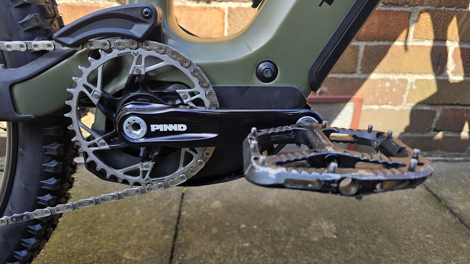

Not work per se, but just ordered some nice Pinned 155mm cranks for the EEB, they'll be going on next week.
Got a product recall email for the carbon cranks (Cube Acid), perfect time to get rid before they explode on me!

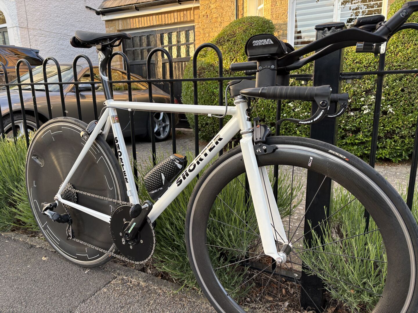

Dusted off the TT bike for a fettle and spin. A few saddle tweaks but the engine is weak . Also rebuilt a track bike after a frame respray - doesn’t take long!

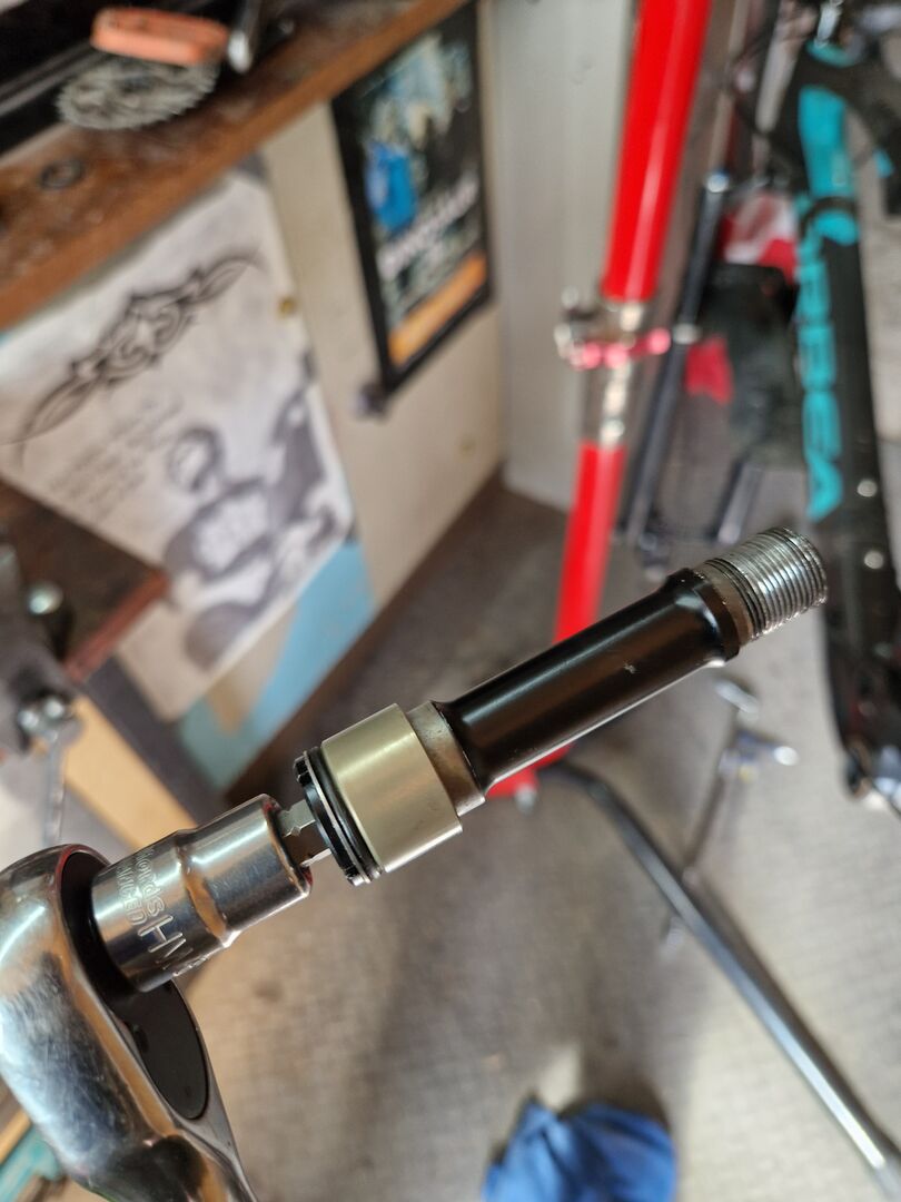

Replaced the rotor and tyre on the back wheel of my Tern. Neither is a big job really but once you factor in actually getting the back wheel on/off the thing the whole affair starts to grow legs so I'd been putting it off for a while.
I will say that a friend's advice to use an electric screwdiver to spin the rotor bolts in and out was genius. Get them most of the way in then torque them properly - took about 2 mins rather than the usual 84 years.

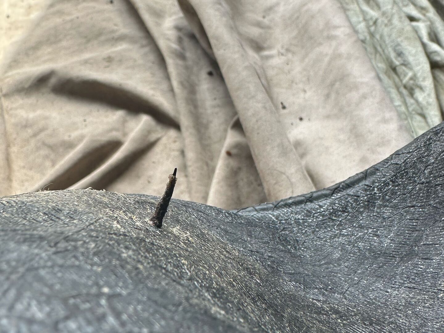

Bought a Nukeproof horizon pedal service kit from Ascend components as my sam hills were starting to develop a bit of rattle after 6 years of abuse (that's right DMR, 6 years before developing a rattle, imagine that!). The kit also comes with new pins so replaced all those too. Pedals feel as good as new.
Unfortunately this resulted in me having a hugey in the shed last night as I was checking the sag on my forks wearing my sliders, I went to step off but the new pins weren't letting go so I ended up falling into the wall and sliding down like something out of a cartoon. Grazed elbow and knee and took a couple of the new pins across the bottom of my toes.

Fitted some new cranks to the Eeb today. Very nice. I like.
Also that click I was chasing has now gone. Coincidence that Cube have done a product recall this week on their Acid carbon cranks that were fitted to it. The pedal insert has been debonding from the carbon. I'm assuming that's what may have been causing the click I was hearing and feeling through the pedals.

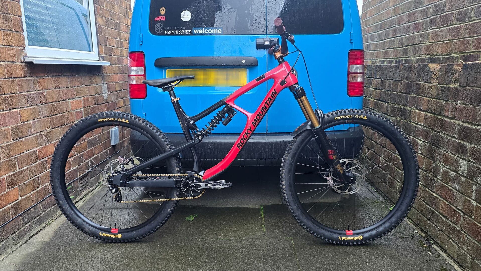

Set up the ShockWiz on the back of Reeksy2's Rocky Mountain on Wednesday as he has always claimed he blows right through the travel on it. Given he's not very big at all I never paid much attention. He did an evening session and recommendations were for an extra 5% air and a token. Did that last night and he should get a ride on it Saturday before a race on Sunday. Hopefully it works as a cheap upgrade rather than replacing the shock with something better.

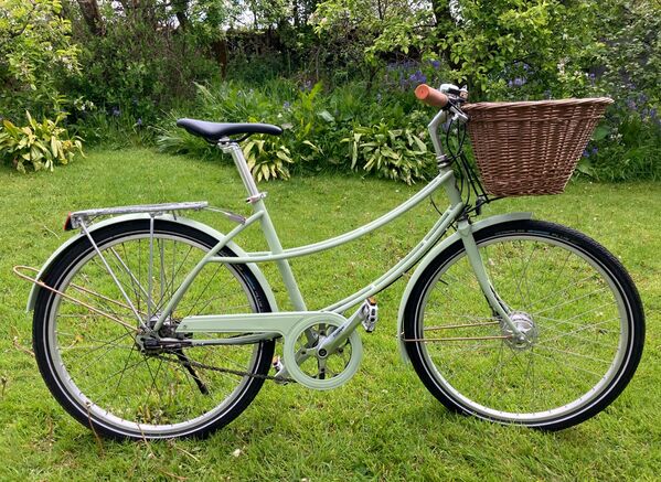

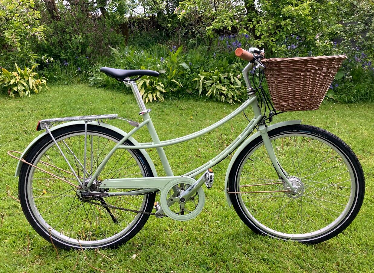

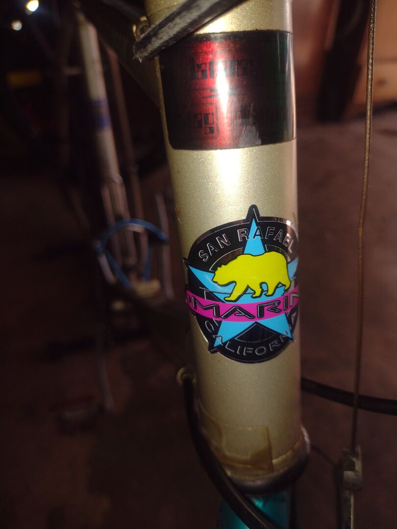

My daughter wanted to take her bike to university in September. I thought it would be better to find a cheap rough around the ages bike rather than the gleaming Pashley that she loves.
I found a Pashley Penny in a sorry state with a rusted frame, bashed mudguards etc. and picked it up cheap. I dismantled it and cleaned it all up a bit. Found the Humbrol spray paint for the colour, sanded down the rust, primered the metal and patch sprayed it up. Not a full respray I didn't want to make it look to good or go to too much effort. I just wanted to arrest the rust and make it rideable for a few years.
It is back together gears and brakes now working. Cheap as chips. Pannier needs levelling.

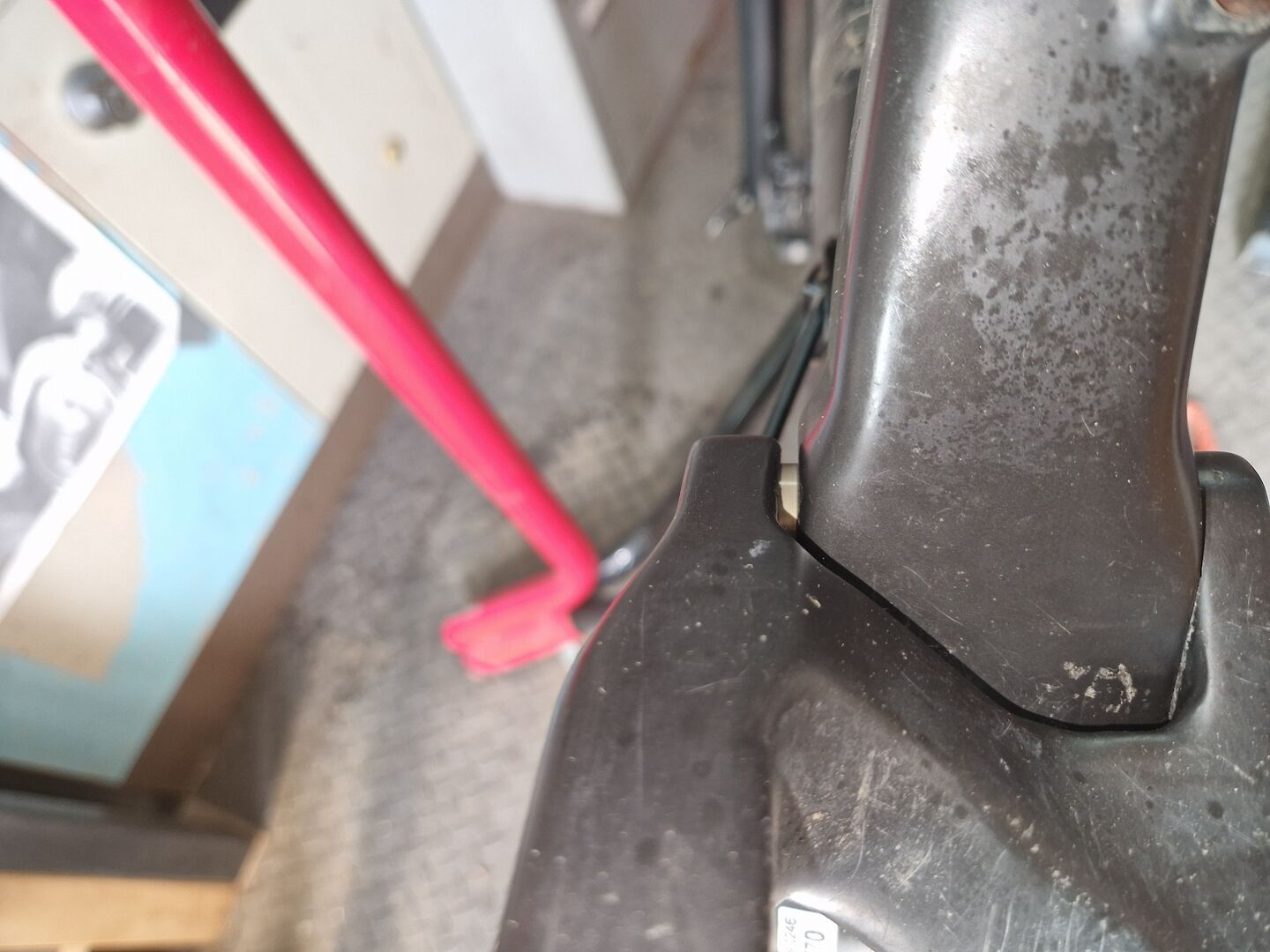

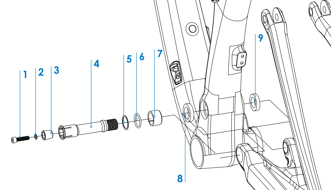

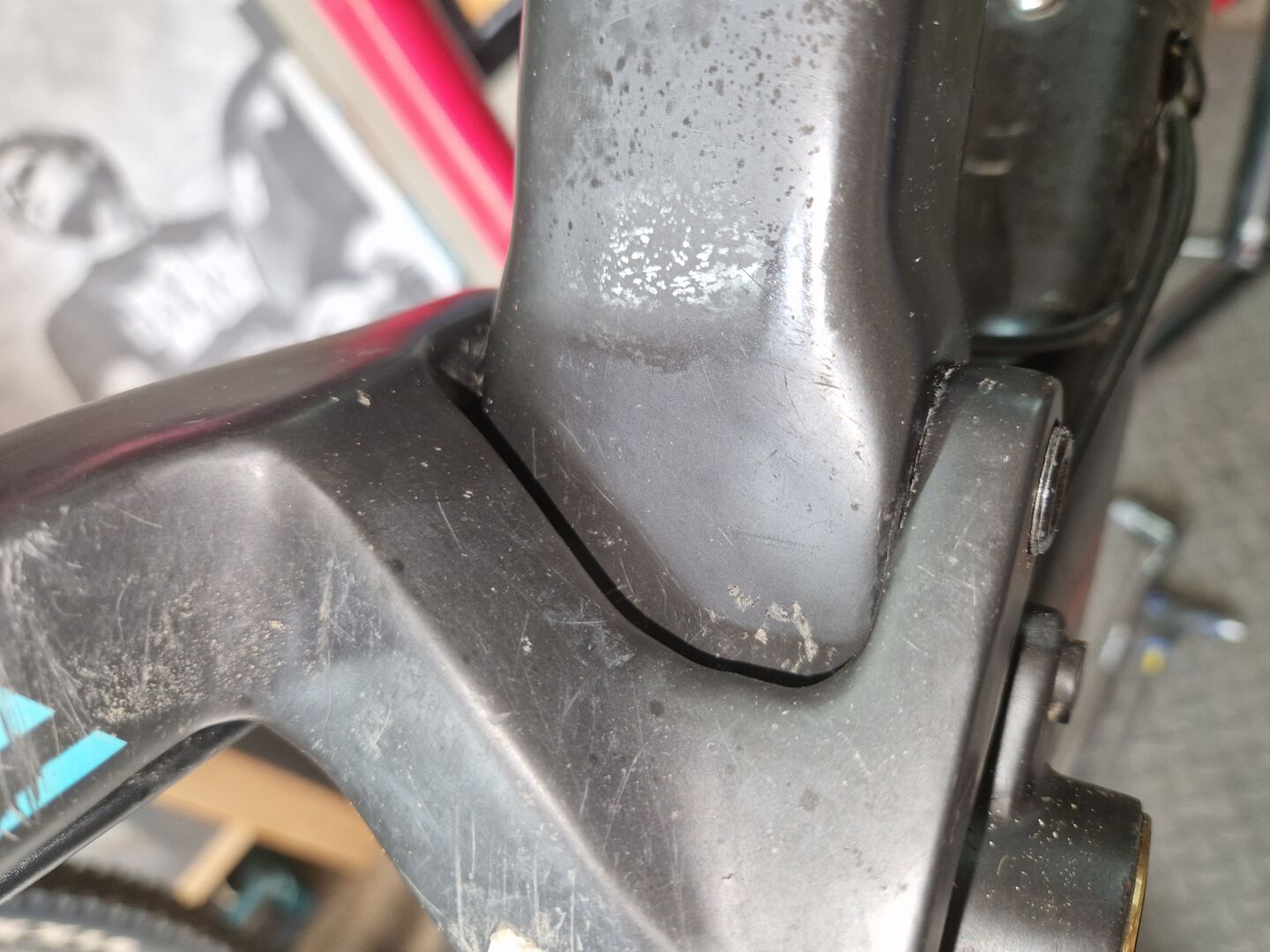

Replaced the frame bearings in my 2016 carbon Occam. Does this main pivot look right to you? There's much more space on one side than t'other, yet the spacer is how big the spacer is, the bearings are definitely seated, everything's in the right order as per the manual diagram, torqued to spec, and I can't see another way of installing it: the main pivot with its o-ring, washer, and spacer have to go in first (before the cone) and be torqued up because the 8mm hex socket is behind the cone.
It's not the first time I've done the bearings but I don't remember it looking like this, but maybe I've just never noticed the offset. Seems to be a common Orbea arrangement - can anyone else confirm?

No help I’m afraid… but I had a Yamaha WR250R that I had the same issue with after doing a bearing change and I never did figure out why.

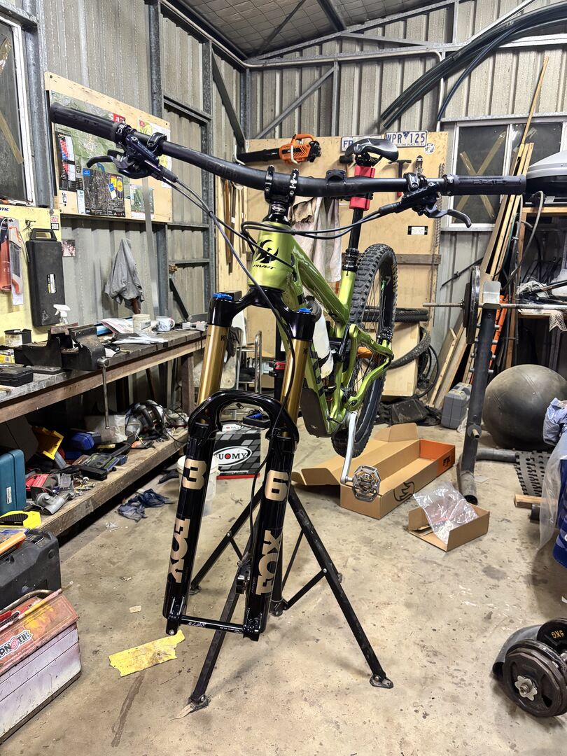

Oh dear I seem to have talked myself around.
Straight from work to my LSS who fitted the crown race, cut the steerer to my spec and talked shit with me for ages.
Then home for dinner and out to the shed for fitting.
I wish the forecast for the next few days wasn’t so crap.
Did that fix the clicking noise you were trying to track down?
