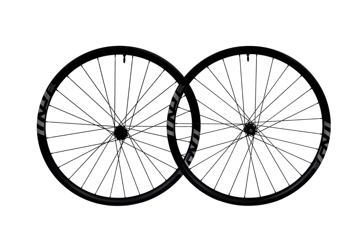

More pertinently, tubeless, then wheels.

+1 for getting a better wheelset and I bet you can drop half a kilo with your £500. That's rotational weight being cut and you will notice it on the trail. I wouldn't change the tyres because those Speccy T5s are already pretty light, and good.
Wheels (and if needed, tyres) are the first things I change on a new bike. But personally that's more because stock wheelsets tend to come with crappy hubs and I'd rather splash some immediate cash on wheels with DT Swiss 350 or above that I know are going to give me thousands of miles of fuss-free riding. I'll then flog the stock wheels as new / like new condition on eBay and claw some cash back.

sport and leisure are still doing the ghost carbon's at bargain price.. 1500g carbon wheels, £400
for a DC bike they would be spot on

I'd look at custom wheels - DT Swiss XM421s on DT 350 or Hope hubs would be awesome on that, and should last for many years.
