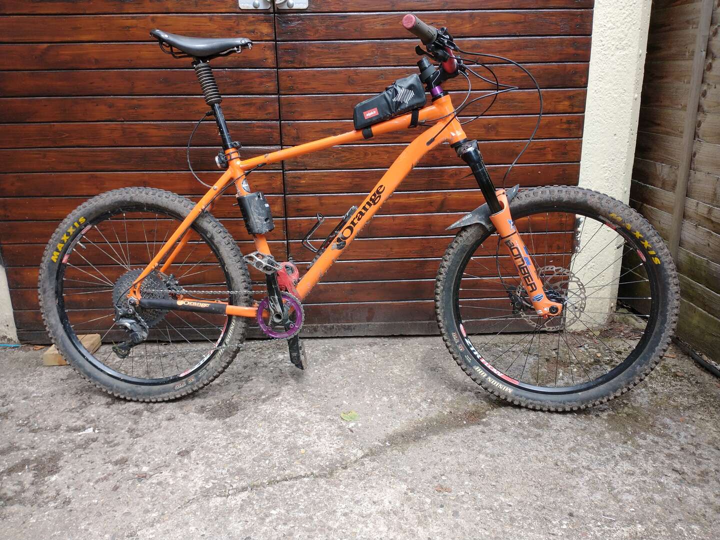

Posts: 3601
My (sadly nicked) orange clockwork was ace. A new frame from sunset with most of a build kit from my cove stiffee.
135mm rear end, -2 angle set.
Mine was a 27.5 frame with 26 wheelsย
150mm forks instead of the 120 it should have had with 27.5 wheels.
The BB was a bit low with a 44 tooth triple. Swapping it for a 34 tooth had me up all the hills round here and was nippy enough on the dh.
