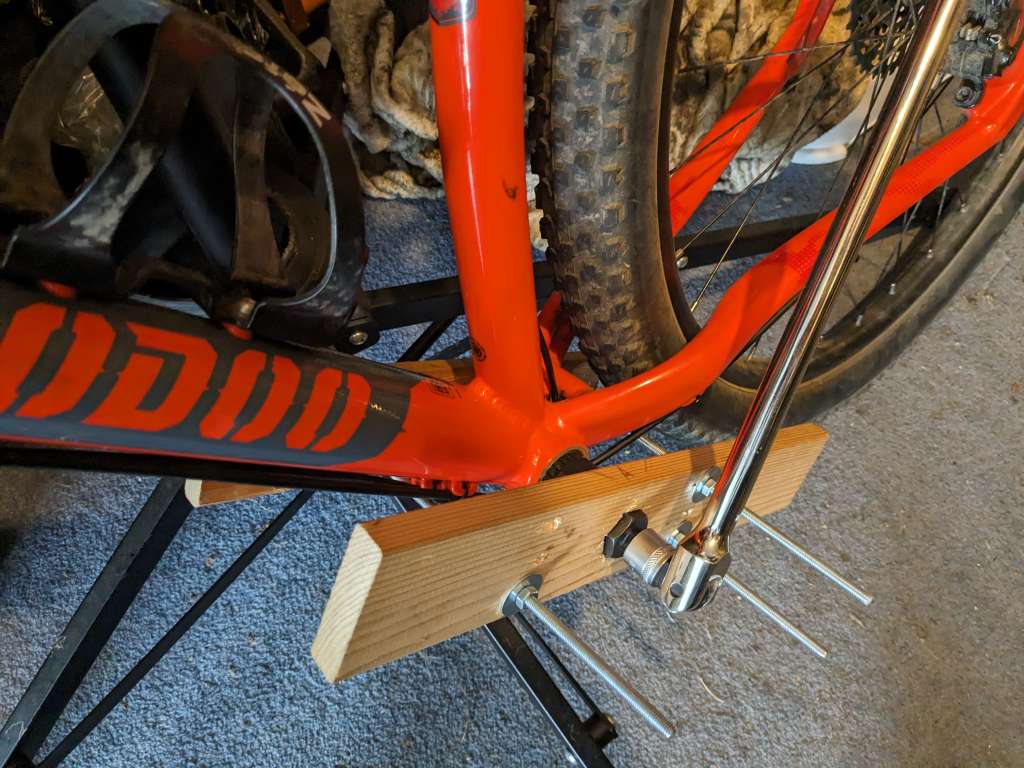

Posts: 120
I bodged this together to solve a similar problem.
PXL_20230617_162258441
Posted : 16/12/2023 1:25 am
crossed, dc1988, joebristol and 5 people reacted

Make a thing like what Sixtoes had done.
Boiling water won't be enough heat so if it's a metal frame use a wallpaper stripper heat gun until you hear a sort of popping noise (no idea what that does to CTO carbon, not tried it) then use the gadget you built but you should be able to stand on the lever. If your tool won't let you out a breaker bar on it see if you can slip a bit of scaffold pipe or something over the end of it to make it longer.
