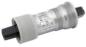

I'm not sure it's that simple. The shell length is printed on the body of these, so there must be more to it than the NDS cup:
[img] http://t0.gstatic.com/images?q=tbn:ANd9GcTRjqu49BMofRAoHqyl134vhMJU2l2nfyVJo8eYulEIgQKVL-UU [/img]

although it's the non-drive side cup determining if the BB will fit into a 68 or 73 shell - the chainline must also be affected.

Yes your right. The only differance is the cup. I've swapped cups before to change the BB length for a different frame and also bodged a 68mm into a 73mm with a spacer.
That makes no sense to me. The cup is on the non driveside so how can there be any difference in chainline?

The relative position of the axle end and the DS flange must surely be different for any given axle length but different shell spec

I've got two UN73s in a box in the garage. One is a 68/113 & the other 73/113. I've just put them side by side, ie lined up the DS flange and whilst the body is the same length, the axle lengths differ.
The 73 has a longer axle on the NDS and the 68 on the DS.
Posted : 10/03/2011 8:42 pm
Posts: 37
And yes the NDS cups are different, i.e the 68 is shorter.
