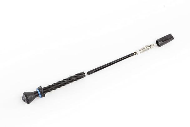

The valve core tends to pick up latex, and then eventually instead of moving up and down, just sticks, at which point either you can't get air in, or you can't stop it getting out.
Milkit have that solved with their valves.
But you can fix that by just tightening it down, unless you don't have a multitool, in which case you can just flag down a passing cyclist until you find someone who does.
Milkit valves come with a valve core tool that resides on the valve stem so that you never forget it.
(I quite like milkit valves)

ooh Milkit looks ace but OMG it's a little pricey
Posted : 03/01/2018 10:00 pm
Posts: 3838
You can buy the Milkit valvestems on their own (pretty standard pricing compared to other brands), but you miss out on the clever bits that set them apart if you don’t go for the kit.
Posted : 03/01/2018 10:29 pm
