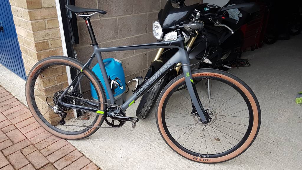

Posts: 978
Yes, did it with my Boardman a few years ago and it’s been brilliant.
It’s running 650b Hunt wheels with 47mm WTB Horizons. It’s also now been upgraded with Force AXS after one of the PSA’s on here earlier in the year.
It’s spot-on for most gravel and has happily done the blue and red at Swinley without issue.
