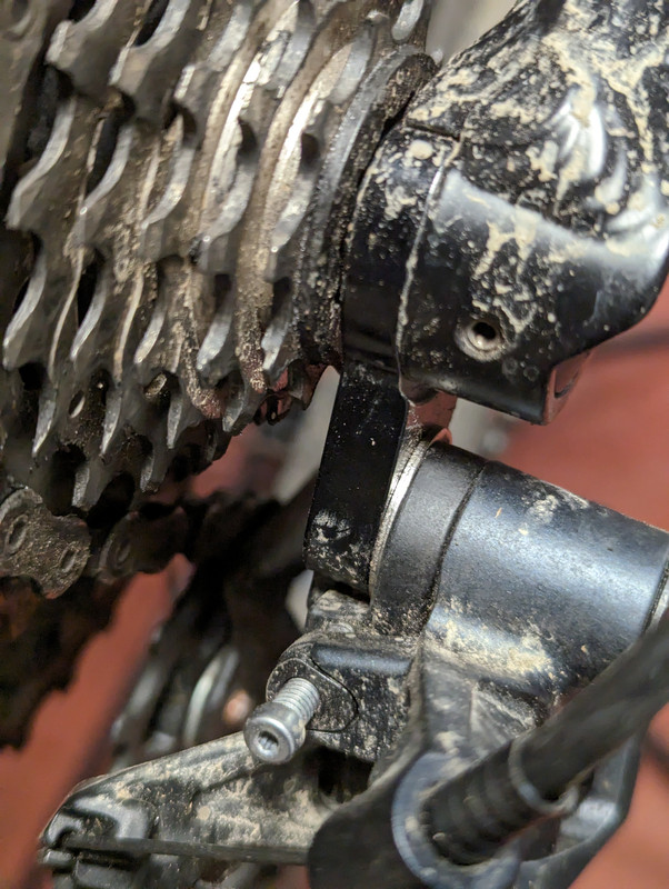

Long story short, new bike has never shifted right and I was too lazy to investigate until today.
The rear mech is behaving like it's too far inboard. It's just very slow and reluctant to shift down the block to the small sprocket and it's always rubbing on the bigger one. I assumed I'd bent something in the Wharncouver crags but everything appears straight.

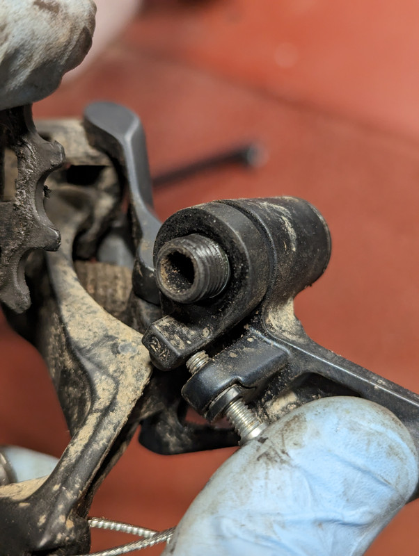

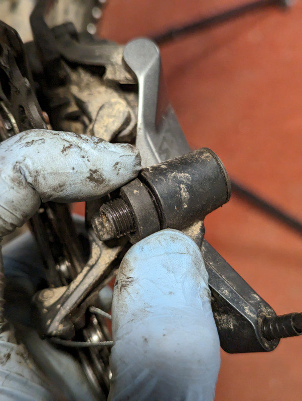

Anyway, I took the rear mech off and the bolt has a lot of play in it. The plastic spacer on the back is very loose and floppy. It's like it's missing a circlip or washer or something.
So if you have one and you're able to check, does this look normal?

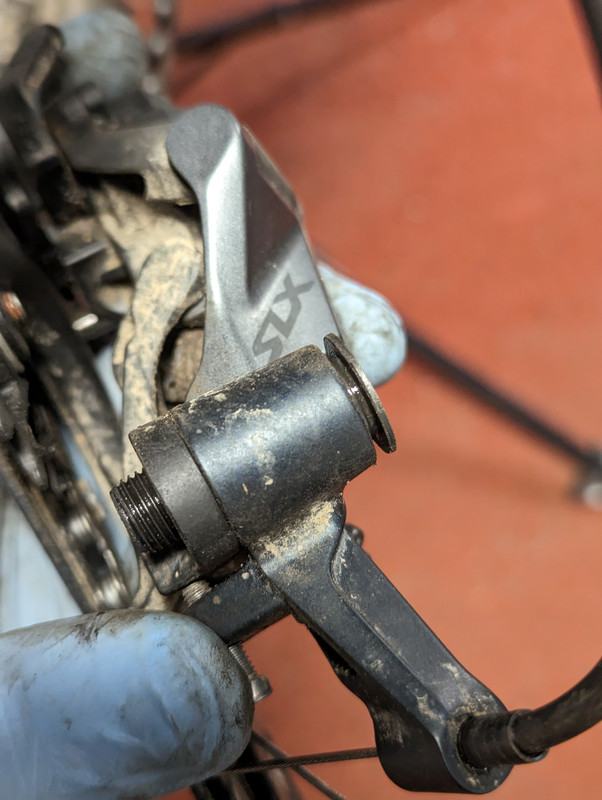

So, I stuck a big washer behind it, like this and it fixed the problem instantly.
So is something missing from the back of the derailleur?

It looks like the circlip is missing.
Best bet is to get on the shimano EU website and plug the full model number in and get the exploded diagram up in front of you.
Posted : 13/08/2023 7:27 pm

As above, looks like the circlip is missing. However, it shouldn't make any difference once the bolt has pulled it all together - it just stops it falling apart when undone.
My first port of call would be to check the hanger alignment (with a tool).
Posted : 13/08/2023 7:41 pm

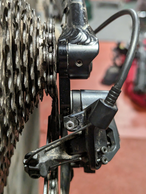

Posts: 9301
Hmmmm. The exploded view doesn't show any washer or spacer, just the tiny little C shaped circlip which is present (just visible in my 3rd picture).
I think it's definitely some kind of spacing issue. It's running perfectly now, exactly as you'd expect. I thought there might be something missing from the hub but people stopped fitting spacers and easily lost end caps from hubs years ago didn't they?

Because the mech is literally too far over by a couple of mm. With no cable tension and no limit screw it won't drop onto the smallest sprocket.
The washer has moved it outboard enough that I can use the smallest cog and gain enough space to use the barrel adjuster to dial it in.

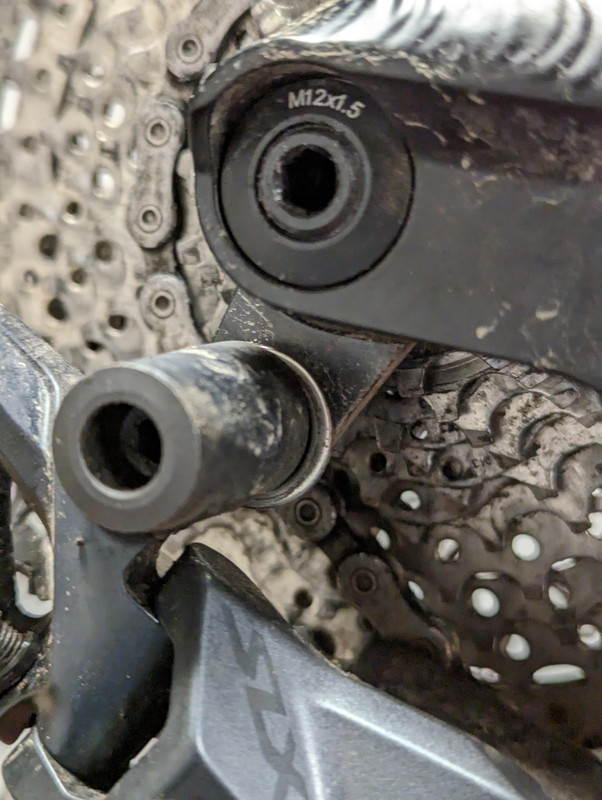

Well I'm not sure what the problem is but I've fixed it. I drilled a a 10mm hole in a washer and bolted it in there. Then I went for a spin around the mountainous streets of Sheffield and it's running perfectly. Should have looked at it ages ago!

Shimano dropout spec is 7mm to 7.5mm thick at the hanger for a conventional qr axle (without digging not sure what the number is for a through axle but it will equate to something similar in terms of derailleur mounting face distance from end of cassette). I make steel dropouts which are sometimes only 5 or 6mm thick, and I then need to add a washer or two like you describe. If the dropout is too thin, then you almost run out of spring tension to reach the limit screw, so spacing it out fixes that by moving it a little further into the spring stroke and increasing tension.

I took the rear wheel out before work this morning. End caps are snug, nothing missing.
I might try to find a washer that's a tiny bit thicker so I can sit further in the adjustment range rather than right at the bottom end.
