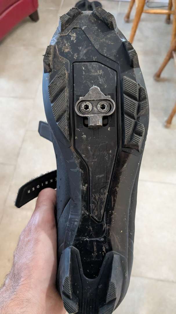

Posts: 1958
Here's the sole after one off road and one on road ride

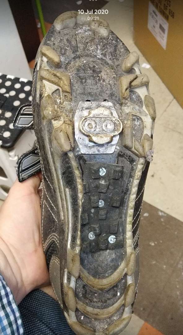

Posts: 17263
I managed to find a picture.
