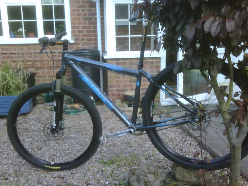

So it turned up out of the blue today ๐Ÿ™‚
Very nice too. EBB is a new design, relies on a sort of expander wedge held together with a round metal spring thing. Easier to see than to explain...

Very nice that.
Any close up pics of the chainstays and seatstays? Looks like they flatten out a bit for a bit of rear end cush.

They do indeed - it's the same as the Moto Rapido. If you ride behind one round Thetford you can see the rear brake hose flex up and down as the stays flex a bit. I'll be at SSUK on it doing a bit of shameless Salsa promotion!

Whats the chainstay tyre clearance like?Saw a pre production one and it was pretty tight.

EBB is [u]not[/u] a new dsign, it's the commonly used Busnhell EBB, also available from Bushnell directly.
I've had one in my EBB 29er SS since 2003 and very nice and easy to use they are too.
The "round metal spring" simply holds it all together out of the bike and maintains side to side alignment of the three main parts within the BB shell when you're fiddling with the EBB position.
See here: [url= http://www.bushnelltandems.com/eccentric.html ]BUSHNELL SITE LINK[/url]

Thanks for explaining it - I'm glad it's a Bushnell as I've heard they're the best EBBs, but until now I'd never seen one! Happy days.
Tyre clearance is better than pre-production - the one we had at the Bike Show was very tight but this one is fine - as good as my 26er race bike anyway. It's fitted with 2.1 Crossmarks and it's fine, finger width at least all round. Its bent around the tyre - square section tubing.

Very smooth to ride, way more compliant than the Rig it replaced. Very stiff, very quiet, very lovely. Faster handling than the Rig too - TT is 15mm shorter and head angle is a bit steeper. Seatstays are a smidge longer though.
