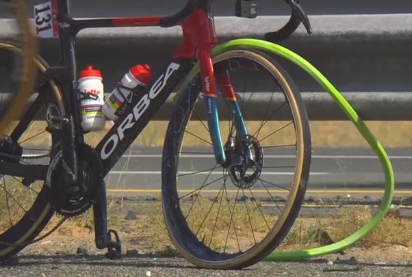

Posts: 4544
Posted by: tthew
Are they using them in proper road races now?
Not sure how widespread it is but here's a pic of Thomas De Gendt's wheel after a puncture* in one of the middle eastern races last year.
* not really a puncture, apparently the tyre they were running was too narrow for the wide rims.
Posted : 23/03/2025 10:35 pm
