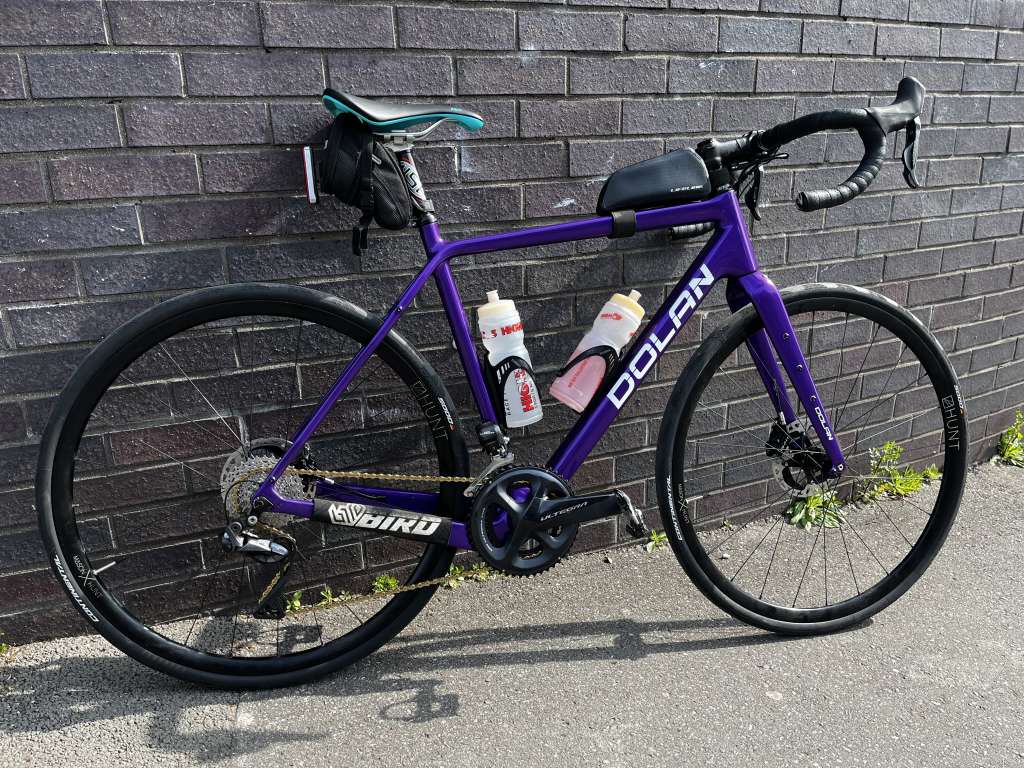

I had a similar brief to yours - bulged discs in my lower back and I was struggling slightly on my caad12. Mainly the harsh front end and position on the bike. I’m less sure having flex in the rear of the frame is an issue.
Decided I wanted a higher stack, a frame that’s more forgiving and to run bigger tyres.
The 2 racey bikes in your list do not do that. So Roubaix out of that list.
I actually bought a gravel frame and built it up for road. Dolan GXC with 30c Conti gp5000s on it. In hindsight I should have gone 32c in the same tyres for even more comfort.
Riding it twangs less off broken road and is generally more settled. Yet it’s still stiff and gets power down well / feels fast / still turns and handles well.
The spec on mine is Hunt 4seasons road wheels, Dolan GXC 54cm, Ultegra di2 11 speed, Ultegra cranks and cassette, Hope RX4 brake callipers, USE carbon post, Fabric Scoop radius gel elite saddle (now an all black one rather then the one pictured), Cannondale handlebar, KMC X11el chain cheapie stem.
I have got a carbon aero style bar and bar end junction box to go on, but I haven’t got the patience to fit it at the moment as it means disconnecting the brakes to route hoses through the new bar and it took me ages to get a half decent bleed on the Hope brakes.

That Dolan is wonderfully purple!

The Dolan looks great! Love the colour
