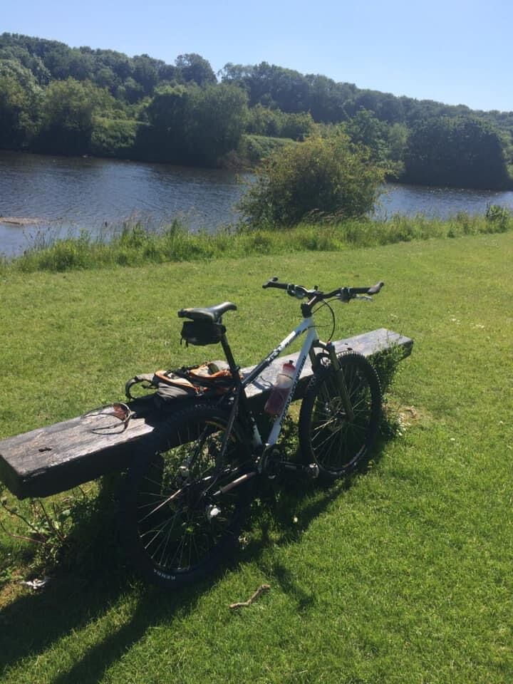

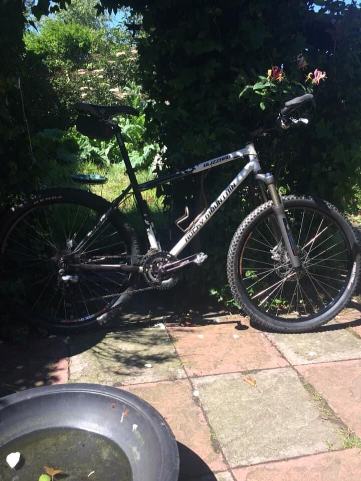

RM BLIZZARD Anniversary - what should I do with it?
Posts: 31
[#13535506]
9 speed XT
18.5” 853 frame - 25th anniversary edition
Fox Talas fork
Hope brakes and hubs
Turbine chainset
26” wheels obvs
great condition
I keep getting analysis paralysis tbh
sell as is?
what rigid fork would fit?
convert to 650b/ gravel- bikepacker? (Partner is 5’ 4” and would love a gravel bike tbh)
No idea of value, but it’s still a great bike and should be getting used

I wouldn't bother 650b/rigid, I'd just reimagine it as your gravel/bikepacking bike in your head rather than actually change anything.  If you must then any 80-100mm sus-corrected 26" fork will be close enough with a 650b wheel up front, I'd not bother out back.
Not sure at 5ft4 your partner would ever fit it, the usual bodge for a monstercross is to go down a frame size to get something around the same top tube length as a road bike, and then make up for it with the extra reach to the drops.
Posted : 12/05/2026 5:01 pm

Ok - here’s where I usually stumble: if I’m changing/upgrading the group set, what will fit? Hope 9-speed hubs/freewheel at present.
1x appeals.
no idea about chain line compatibility on an older frame?
Posted : 13/05/2026 1:42 pm
Posts: 10820
Easy, a non-boost NX groupset works perfectly on a bike built for 3x9.
I bought the whole groupset in a box (cranks, cassette, mech, shifter and cables) and all I had to do was get the correct Dub BB and I've got super shifting.
Posted : 13/05/2026 6:35 pm
