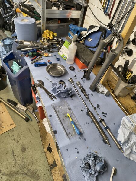

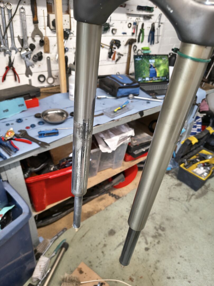

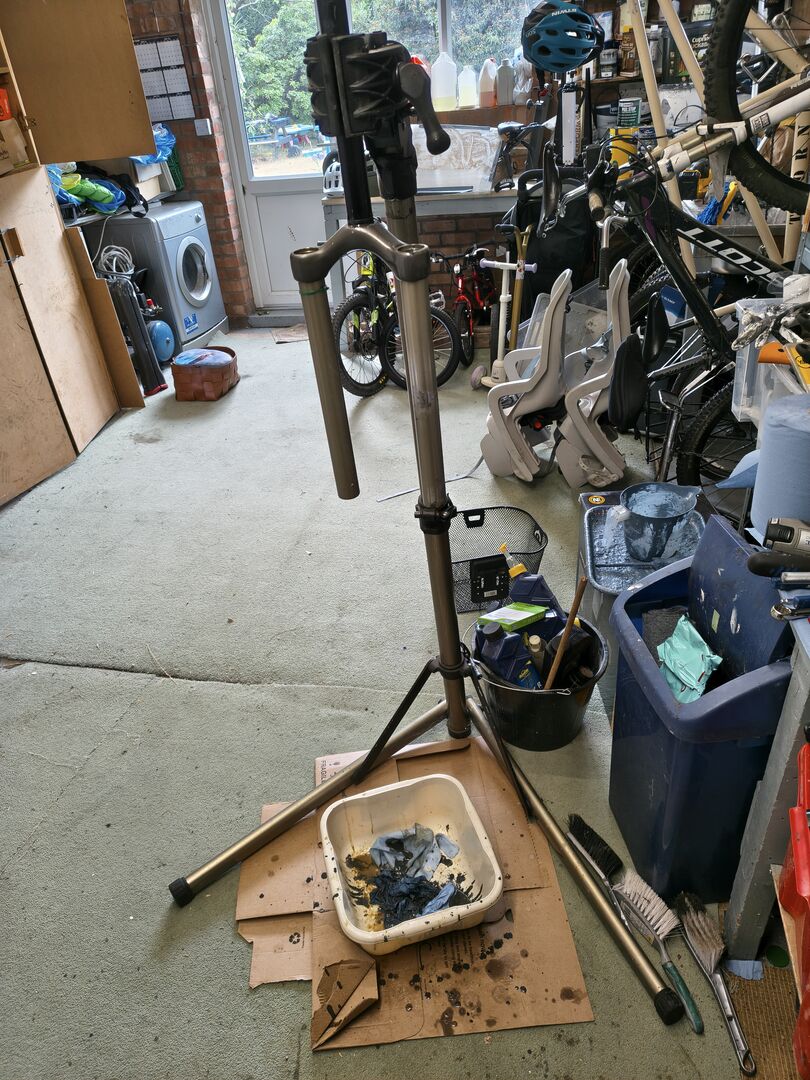

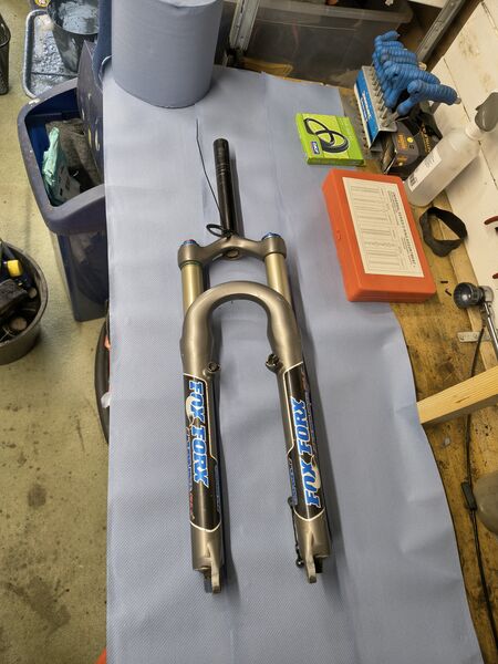

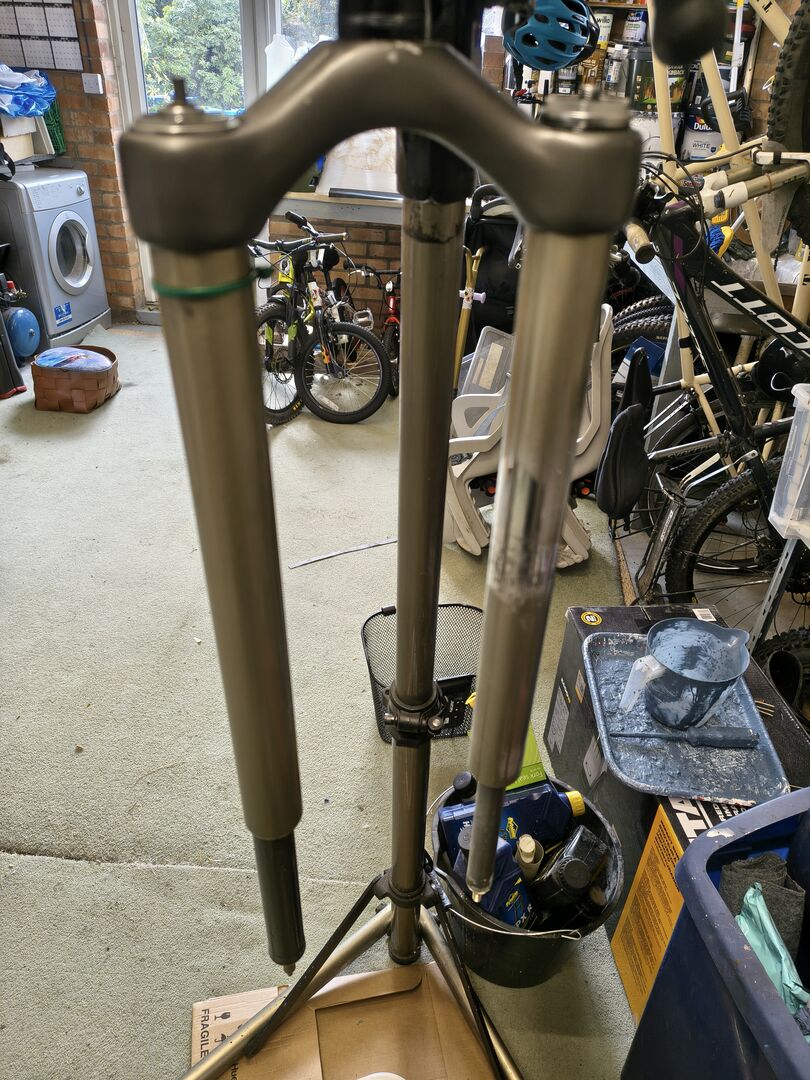

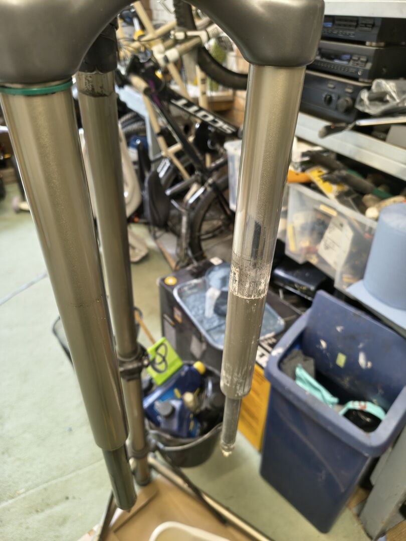

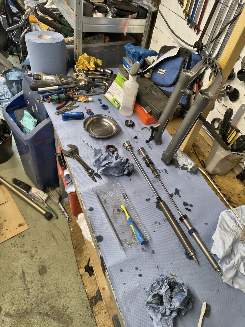

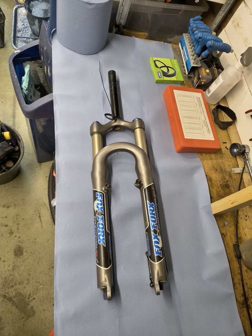

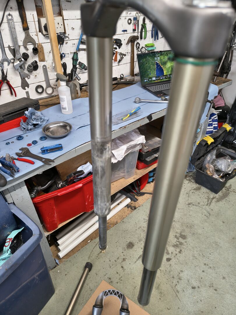

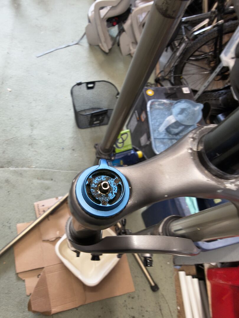

Well
Who knew a 20 year old fork might not have perfect lowers.
One side has corroded massively.
Still with a service and some new seals. But it is never going to be perfect.
Images are in reverse order. I still have to reassemble it with new o rings.
IMG_20260816_122725285_HDR.jpgIMG_20260816_122722734_HDR.jpgIMG_20260816_120305400_HDR.jpgIMG_20260816_120301269_HDR.jpgIMG_20260816_113128461_HDR.jpgIMG_20260816_113124096_HDR.jpgIMG_20260816_105132774_HDR.jpgIMG_20260816_104603693_HDR.jpg
Posted : 16/08/2026 6:13 pm
Posts: 3752
I found something I thought was paper inside. On closer inspection it's a bit of bushing that has become detached
Posted : 16/08/2026 6:14 pm
