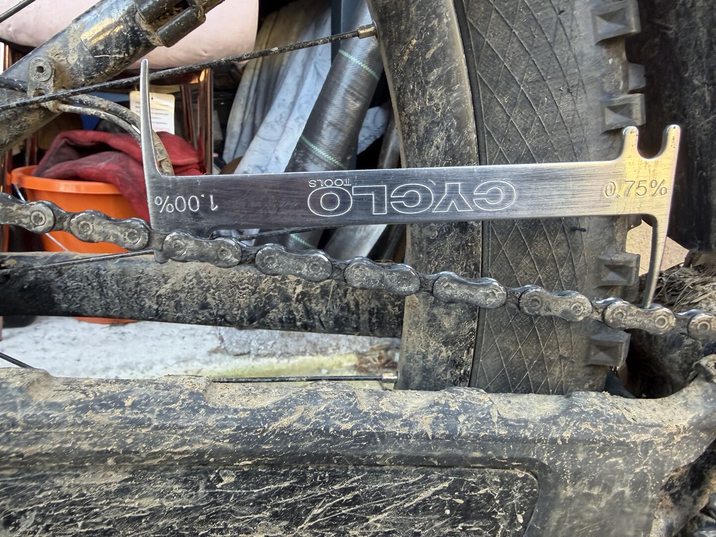

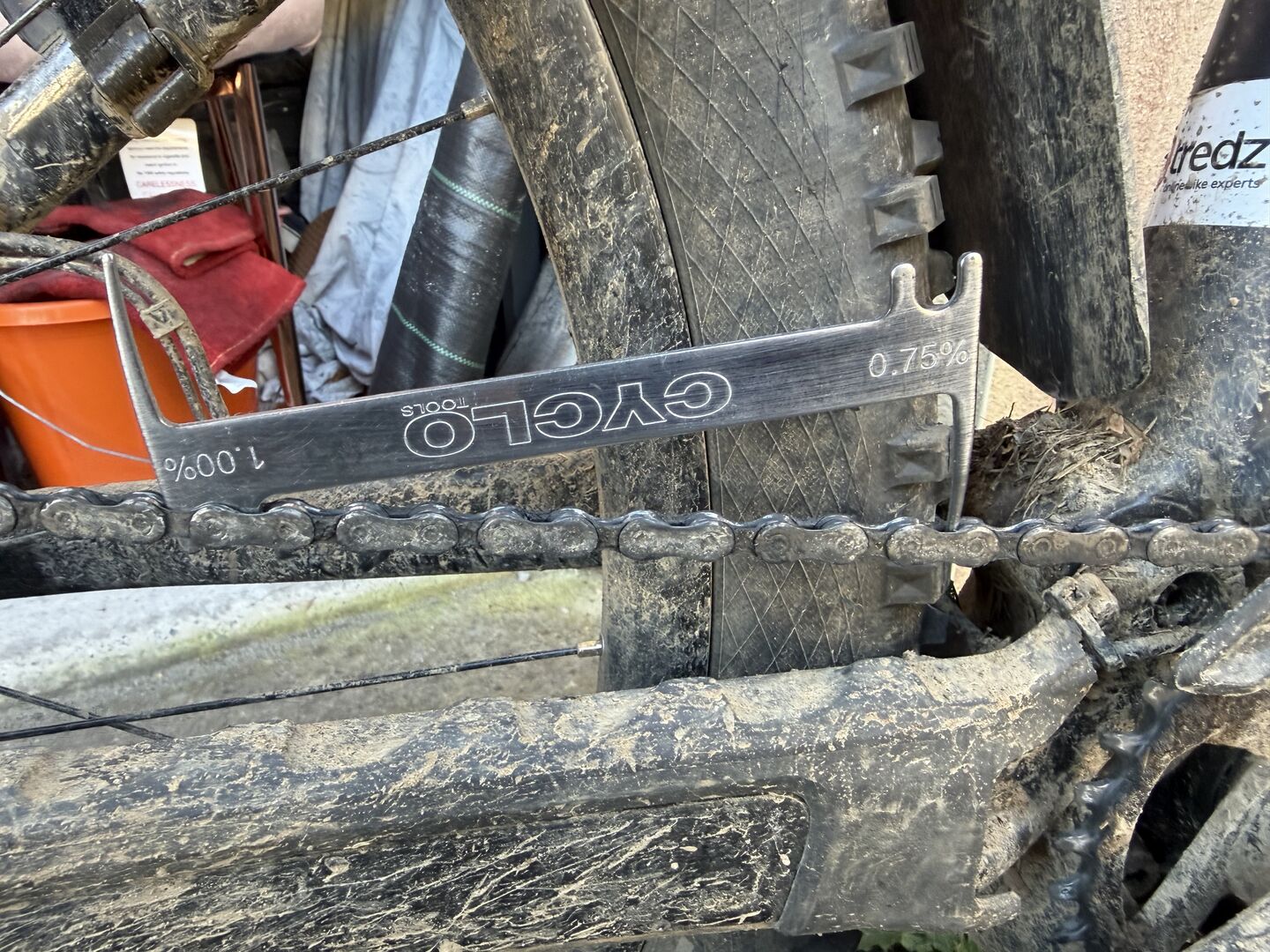

I’ve bought the XT Di2 upgrade kit and thought I’d check for chain wear, I’ve got an e-bike and have done 478 miles on the chain, I’ve  heard they wear a lot faster.
I put the chain wear tool I’ve bought into the chain and 0.75 goes into the chain after pushing it down. I’ve got a 12 speed cassette, I’ve read that you should change the chain when it goes to 0.50, when I use the tool should it just drop into the chain to get the reading?
Even though I’ve been riding Mtn bikes for at least 30 years I’ve never changed just the chain, I’ve changed it all when the gears slip.

12 speed is meant to be changed at 0.5 wear but not all chain tools are that accurate
It should just fall in and not need to be pushed
E-bike drivetrain will wear faster, ways to help it last longer is regular cleaning and oiling, shift gently and not under load
The higher end Sram chains seem to last a lot longer than their Shimano equivalent
You can do what you have done in the past and just ride until it begins to slip before replacing the whole drivetrain but id still keep cleaning everything regularly and pay close attention to the chain and remove it from the bike for cleaning and inspect for and signs of cracking plates etc….

Chain checker until the 0.5 drops in, then switch to a 12" rule to check the actual wear (i actually have a 50cm...).
Chain Checkers are notoriously inaccurate.

Zero Friction Cycling has a "chain wear checker" comparison. Some of the tools are next to useless. Some are good though.
Chain-Wear-Checkers-Table.pdf
