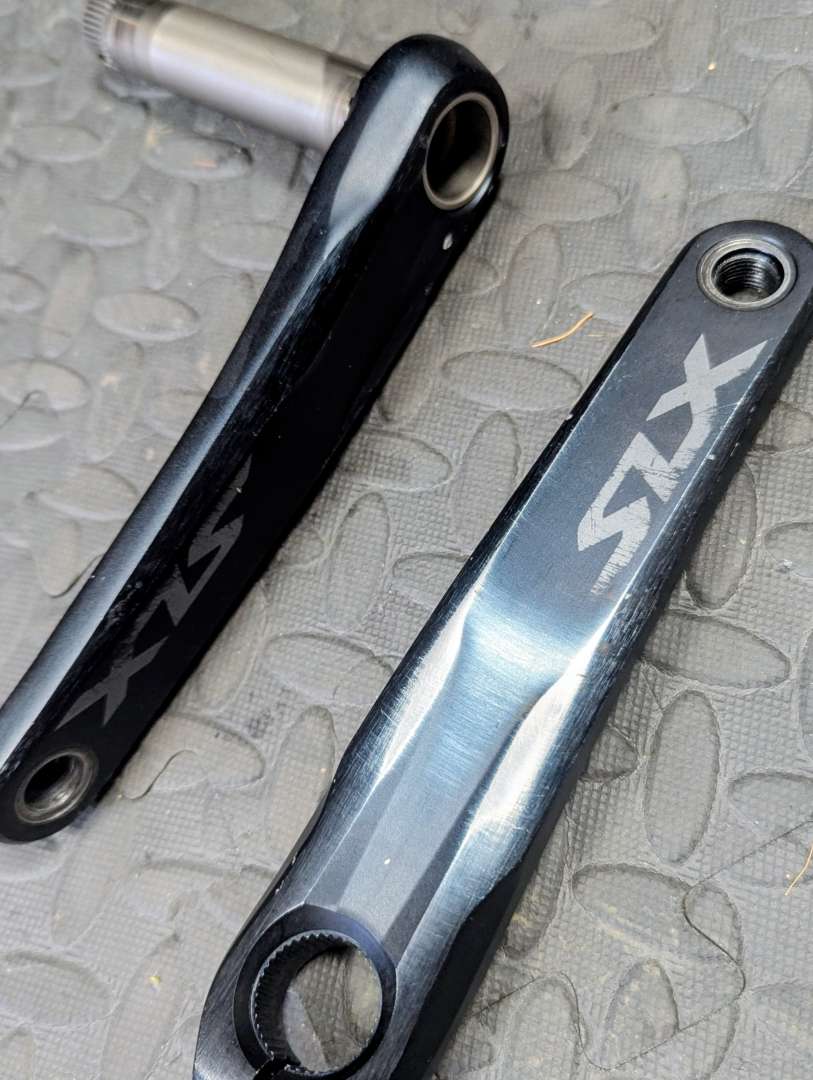

Think mum bike would look better with silver cranks. Nice new cranks, chainring plus BB would set me back the best part of £400. My SLX cranks are scratched, suffering from heel rub and mechanically sound.
Thinking of removing the anodising using caustic soda (sodium hydroxide). Anyone tried this before with success? Other than potentially losing my sight and ending up in A&E is there anything I need to be aware of?

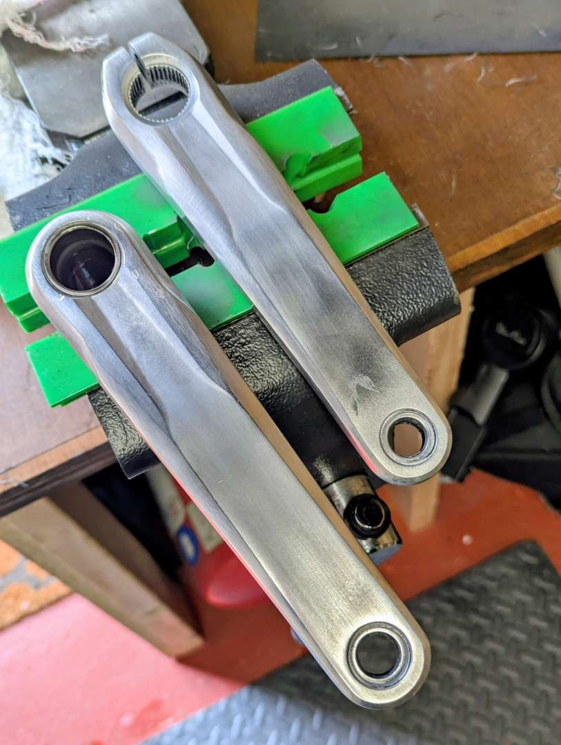

Posts: 9065
You kind of need to polish them. The raw finish is a dull grey with a rough surface. I used a polishing mop in a drill to buff them up.
They don't stay bright and shiny but they look a lot better than when they're freshly stripped.
Don't be shy with the oven cleaner, it's not very aggressive. Just soak them and leave them for ages. Checking them and brushing them every 5 minutes is just more work.

Posts: 3355
A few years back now, it was Mr muscle oven cleaner. Leaves them a rough grey colour that comes off easily with brillo. Quick going over with autosol/silvo works a treat.
Mostly used on stuff that was polished and anodised, so came up mirror, anything more satin and anodised may require something more gritty to polish, but if you're just after clean silver look then oven cleaner and Brillo will do the job.
Posted : 18/01/2026 10:44 am
 st
Posts: 1445
From memory the oven cleaner removes any dye or colouring applied during the anodising, if the material was smooth polished before anodising it’ll be smooth after stripping, likewise if it had a slightly textured finish pre- anodising it’ll remain coarse afterwards.
Either way the aluminium might be a little patchy in colour once stripped so I’ll be worthwhile at least giving them a quick once over if not a full polish.

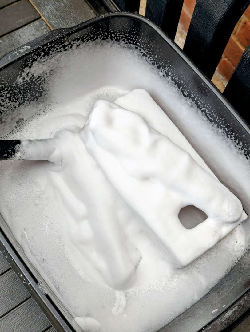

Right... The cranks have been soaking in a mass of foam provided by Mr Muscle for the best part of two hours.
They're a bluey colour and even when rubbing down with a Scotch-Brite pad there's still a fair amount of anodising left.
How was it supposedly so easy?
Posted : 19/01/2026 4:05 pm
Posts: 7630
Mr Muscle isn't that strong, or useful for stripping anodising. Oven Pride is the best stuff, BMXers swear by it.

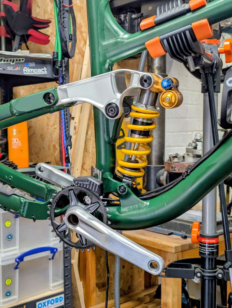

https://postimg.cc/87K361SJ
Done.

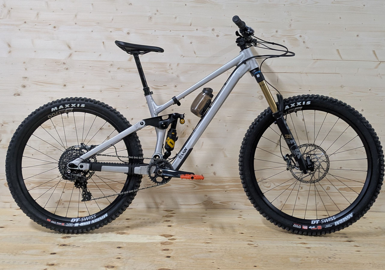

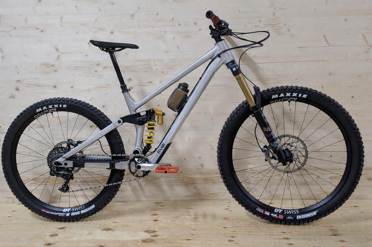

Posts: 13455
Nice and tidy now....they just don't really match the frame now- just a shade or 3 off. Maybe as they oxide they will look closer to the frame colour.
Given a choice, black to match the rocker would have been my choice.
If we are obsessing about colour combinations are we ignoring the elephant in the room...the orange pedals and yellow coil?
Posted : 19/01/2026 7:32 pm
Posts: 13252
I cant bring myself to run yellow grips (which would have to match the yellow pedals) as I think they look naff. I was torn when choosing between the Öhlins and Fox DHX2, but was swung by the reports of the DHX2 suffering from some squelchy oil issues. The orange grips and pedals are the same ral as what Fox use on their Factory stuff... Thought that the pedals and grips would at least match the forks, but they've seemingly gone gold and ditched the orange.🫤
The cranks were previously black, but the anodising had worn through which, again, looks naff.
I've got plenty of oven cleaner left over. Could always do the rocker 🤪 to match the cranks.
